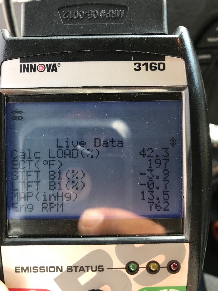

I was able to get fuel trim data. this is what it revealed.
Idle
STFT = -3.9%
LTFT = -0.7%

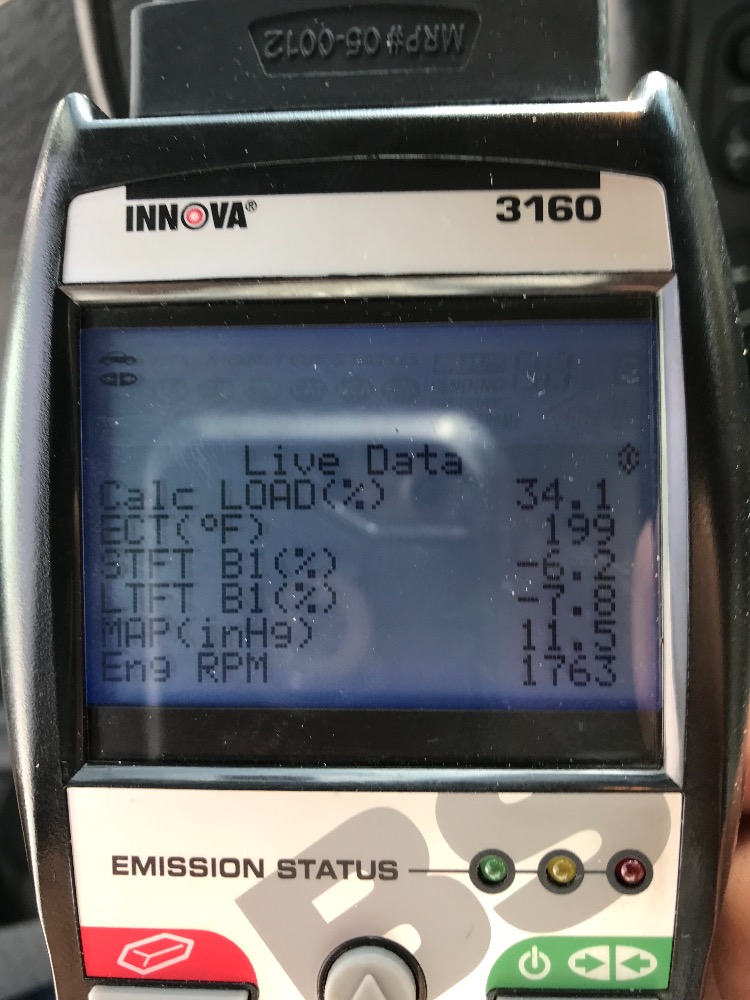

1500 RPM
STFT = -6.2%
LTFT = -7.8%

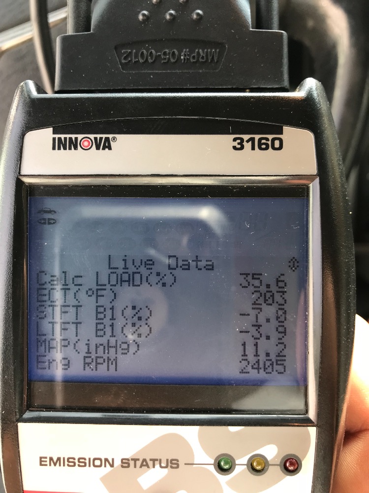

2500 RPM
STFT = -7.0%
LTFT = -3.9%
Obviously if I'm interpreting this readings correctly, there's a fuel system issue. the computer continuously is taking away fuel. something in the system is adding fuel. Don't know what it is. Can you help me interpret these readings correctly? The 3 other questions I will answer during the week as time allows. But I will answer all 3 of them. thank you Weycraze

You're sure about the cat not being plugged? :huh: Because that sounds exactly like an exhaust restriction. The rich fuel trims would tend to support that.
I wouldn't bother with a fuel pressure test, as the rich trims tell you it's getting enough fuel. I'd suggest a WOT run through first gear while watching the upstream O2 and the MAP. If the MAP shows atmospheric pressure, and the O2 stays rich, then fuel and the intake are not at fault.

One thing that really bugs me is the Calculated engine loads.
42.3% @ 762 rpm
34.1% @ 1763
35.6% @ 2405
I have a question for Tyler, do these numbers further support a possible plugged exhaust? I would expect Calc LD to increase with rpm.
This is high at idle, low, then high!
Never stop Learning.
7 years 11 months ago #23205 by Tyler
I think that's directly related to the MAP sensor behavior? In his pictures, you can see the MAP is lowest at idle, and improves off idle. That's typical intake vaccum behavior, IMO.
Not super familiar with MAP sensor Load calculations, TBH. :blush: It's not a PID I normally use on speed density systems.
