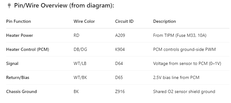

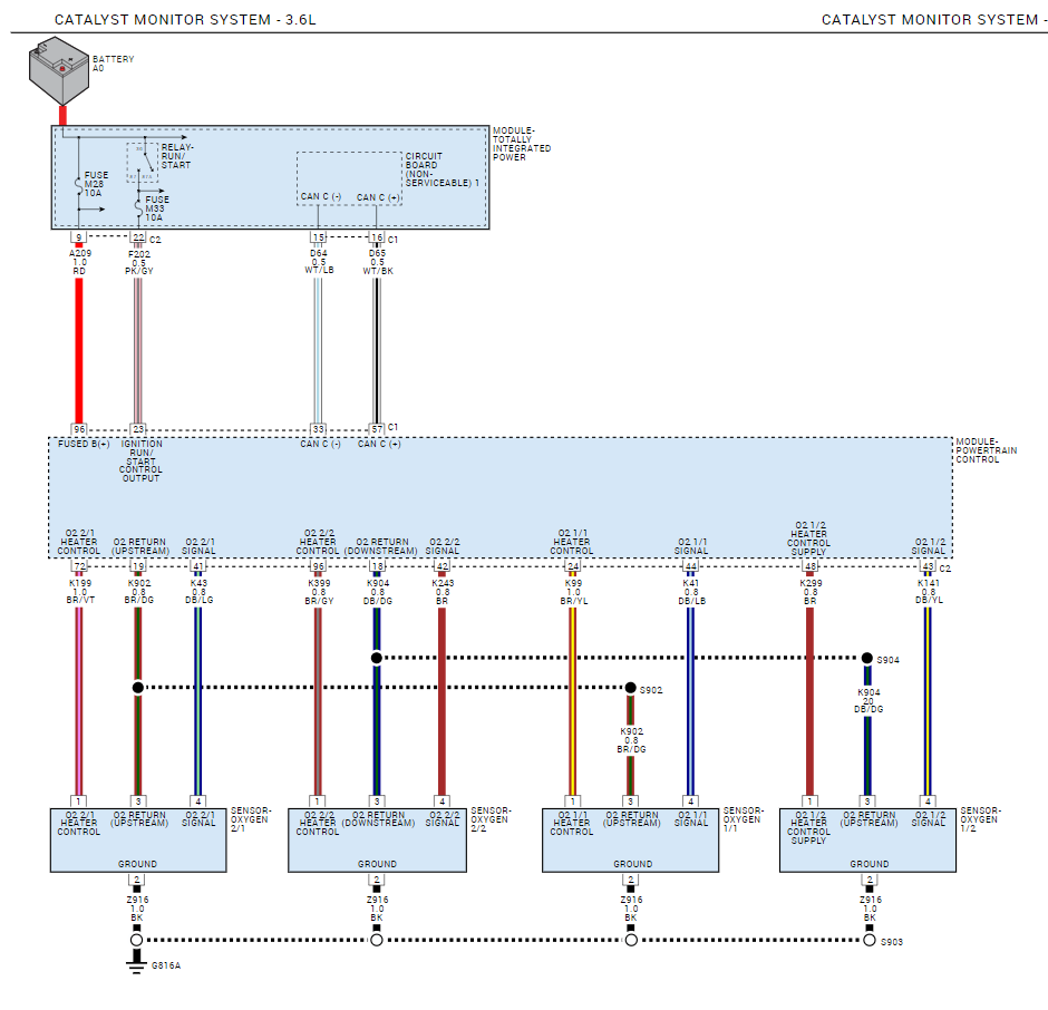

1. Check Heater Circuit (P0032)P0032 = O2 Heater Control Circuit High → usually means short-to-power, failed heater, or PCM driver fault
.🔋 Step A: Check for Power
  • Key ON (engine off)
  • Backprobe heater power wire
  • Should see ~12V+ on the power side (ASD-fed)
  • If not, check fuse, ASD relay, or harness
🧲 Step B: Check Ground Control (PCM side)
  • Connect multimeter across heater power and ground wires
  • Start engine → you should see 12V across the heater
  • Or test heater ground wire to chassis ground:
    • Engine running → should pulse or show low resistance to ground
🔥 Step C: Check Heater Resistance
  • Unplug sensor, measure heater pins across connector
  • Normal range: 3–15 ohms
  • 20 ohms or OL = open heater
  • 0 ohms = shorted heater
❗ If the heater is shorted internally, it can bleed voltage into the signal wire, triggering P0132 (voltage high).

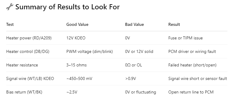

✅ 2. Check O2 Signal Wire (P0132)P0132 = O2 Signal High (stuck above 0.9V)
📏 Step A: Key ON, engine OFF — check voltage on signal wire:
  • Should read around 450 mV (bias voltage) from PCM
  • If you see >0.9V, that could mean:
    • Signal wire is shorted to 12V
    • Heater circuit bleed into signal line (common if heater fails internally)
🧪 Step B: Wiggle Test
  • Lightly tug/bend harness from sensor connector to PCM
  • Watch for voltage jumps or dropouts
  • If voltage fluctuates with movement → harness issue or corrosion in connector
✅ 3. Voltage Drop Tests If you want to ensure wiring is clean, do these with engine running:
 Voltage DropASD
→ sensor power pin<0.5V dropHeater Ground DropPCM ground driver
→ chassis<0.5V dropSignal GroundO2 ground pin
→ battery groundnear 0VSignal WireO2 signal pin to PCM pin<1Ω resistance or <0.2V drop under load

It's still leaning towards an O2 sensor.  Chrysler's respond best to OEM sensor's IMO.
Here is the reply:
✅ Full Wiring Integrity Check – O2 Sensor 1/1 (B1S1) on 3.6L Pentastar
🔧 Component: O2 Sensor 1/1 (B1S1)  Located on Bank 1, upstream, this sensor includes:
  • Heater circuit (control side)
  • Signal wire
  • Sensor ground
  • Bias return wire
How:
  • Backprobe RD (A209) at O2 sensor plug
  • With key ON, engine OFF, you should see ~12V
🔧 If not: check Fuse M33 (10A) in TIPM and TIPM relay output
✅ 2. Heater Control Test (Ground side, DB/DG - K904)Goal: Check PCM's ability to ground the heater

✅ 3. Heater Resistance Test (Sensor unplugged)Goal: Confirm heater isn’t shorted or open
How:
  • Measure resistance across RD (A209) and DB/DG (K904) at the sensor plug
  • Should read 3–15 ohms
🔥 0 ohms = shorted → can bleed power into signal
⚠️ OL = open → won’t heat → sensor responds slow → fuel trim errors
✅ 4. O2 Signal Voltage Test (KOEO)Goal: Check for stuck-high or false bias
How:
  • KOEO, backprobe WT/LB (D64) – the signal wire
  • Should read ~450–500 mV bias voltage (from PCM)
⚠️ >0.9V = possible short to power, failed sensor, or heater bleed
❗ PCM disables feedback control if signal is pinned
✅ 5. Bias Return Integrity Test (WT/BK - D65)Goal: Ensure bias return is intact
How:
  • KOEO, backprobe WT/BK (D65)
  • Should also see ~2.5V bias
If this wire is open or corroded, PCM may read floating voltage on signal line
✅ 6. Wiggle and Load Tests
  • While monitoring all above, gently wiggle the harness from sensor to PCM
  • Check for voltage spikes or dropouts
  • Optionally, load test each wire with a test light to confirm current-carrying ability

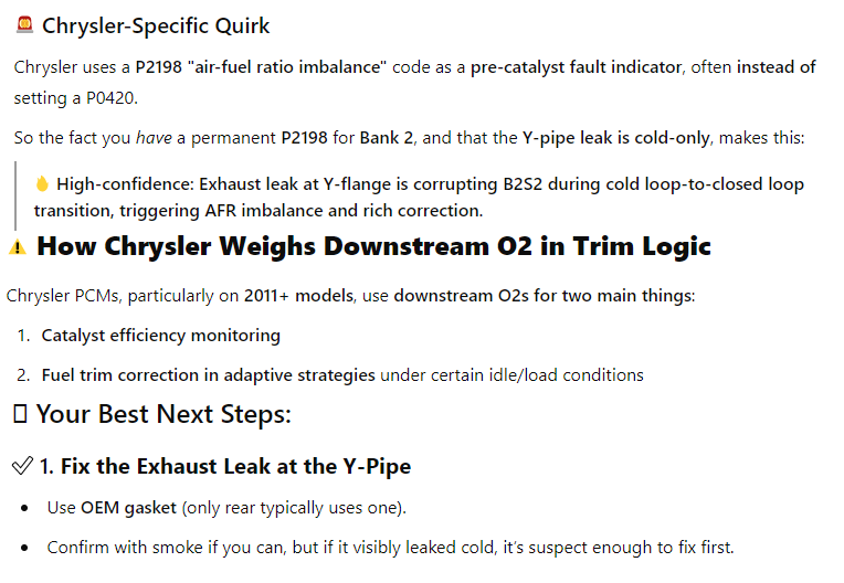

Well well well I found something new today.
Turns out on a cold start I have a exhaust leak under the van at a connection flange.  (just as the exhaust starts to head backward.     It was actually pretty substantial.   Really not to surprised since it sounds like it has a leak but every time I looked it never seamed to leak.Weird thing is after driving the van for a bit the leak appears to be gone.  All coming out the tailpipe.
Could this "leak" cause the "fishbite" idle with no codes?
Does any one have a diagram of the exhaust connections and related gaskets? I have tried to find this before and found way to many different diagrams.
I think I will smoke test the exhaust once my new heated wire comes for the DIY smoke machine.   Make sure there are not any other leaks.  Or could this point to a plugged up exhaust.  (Not sure it is bunged up.  We did a seafoam upper cyl treatment where you empty a can through throttle body and then let it hot soak.  When we fired it up we got the smoke plume that follows that treatment).
Edit : After watching a few videos it appears it is the connection from the cat. pipes to the y pipe.
Is there only 1 gasket on there-looks like rear is the only one that uses a gasket?)
I am sure that is where mine was leaking.
Also I know my flex pipe mesh is loose but maybe a leak there as well. I guess I will be able to see a leak if there is one when I smoke test the exhaust.
Last edit: 1 year 6 months ago by Deadbolt Don.
1 year 6 months ago - 1 year 6 months ago #87257 by Paul P.
 You can always put a shopvac in the tailpipe in Blow mode and Spray Soapy water on the exhaust system to check for leaks, Good find!!!!
Never stop Learning.
Last edit: 1 year 6 months ago by Paul P..
The following user(s) said Thank You: Deadbolt Don
1 year 6 months ago #87356 by Noah
I like to use compressed air and soapy water to find exhaust leaks as well. I feel like the smoke machine isn't really the best tool for that job, but that's me. Other people use the smoke machine with success.
I don't want to derail your process but I have seen burned and chipped valves on these that will barely miss at idle and clear up under load.
If you can use the data to narrow it down to a single cylinder that's misfiring that most, it may be worth while to perform a leak down test on that cylinder.
