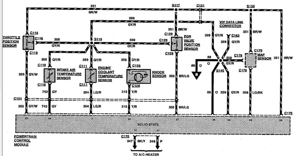

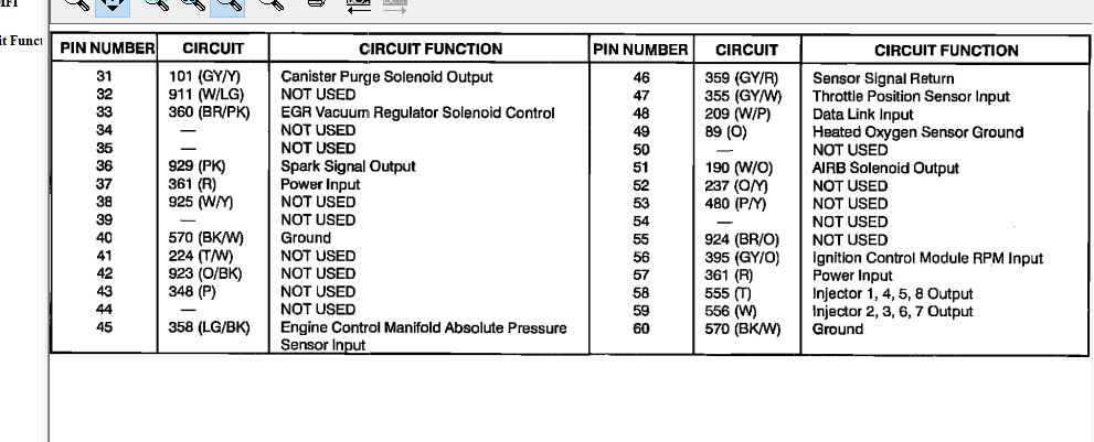

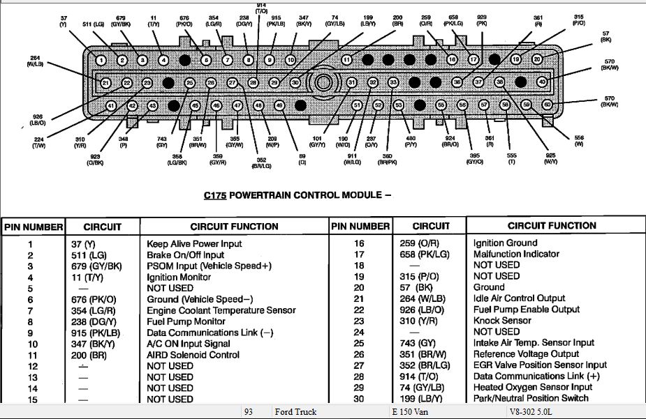

needing a wiring diagram of the engine management system. im not getting a 5 volt ref out of pin 26 of the pcm on the brown/white wire. i dont have service information for this old thing. thanks!
