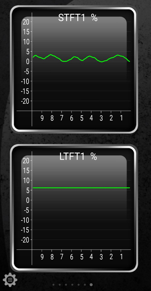

The 2002 Trailblazer has approximately 167k miles on it. In general, this truck runs great especially on the highway. It idles around 610 rpm consistently. Work performed in the last year includes: new plugs, new coils, MAP sensor, fuel filter, throttle body was cleaned twice and new gasket, air filter, camshaft position sensor, variable valve timing solenoid, battery, fan clutch, water pump, thermostat, transmission flush and filter. About 3 years ago (approx 42K) the upstream and downstream O2 sensors were replaced and a remanufactured Jasper transmission was installed.
Problem 1: Sometimes after it is warmed up, when I come to a stop, the idle drops but it usually catches itself. Occasionally it will stall. I notice this more when I go from drive to reverse to back into my driveway.
Problem 2: Within the past month or so, I am smelling gas fumes.
Problem 3: I am noticing it cranking a little more to start.

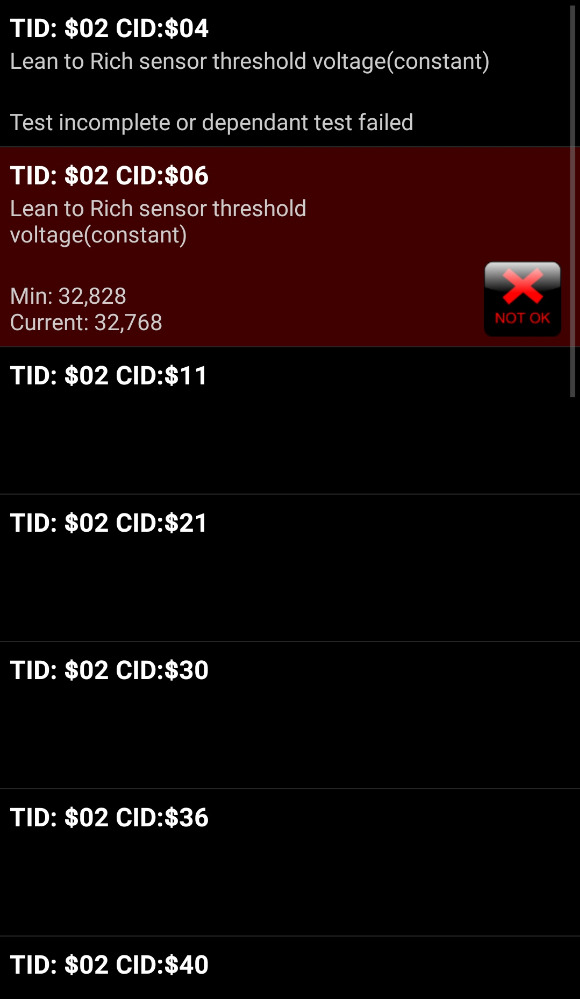

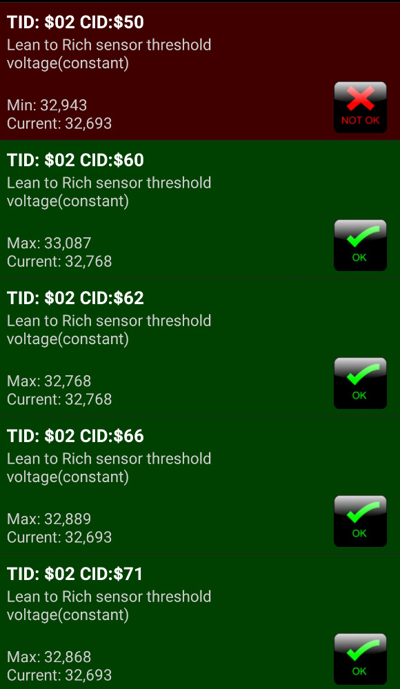

Problem 4: TID: $02 CID: $06 Lean to Rich sensor threshold voltage (constant)
Problem 5: TID: $02 CID: $50 Lean to Rich sensor threshold voltage (constant)
I inspected for vacuum leaks to no avail. I did check my fuel pressure and it was within spec 48-54 psi. The fuel pressure regulator has a hose connected to the air resonator. I do not notice any vacuum from this port. My understanding of the fuel pressure regulator function is at idle there should be more vacuum applied to the regulator so that the diaphragm allows less restriction for return. When I manually apply vacuum to the regulator, the measured fuel pressure drops so I assume the fuel pressure regulator is working properly even though there is no noticeable vacuum applied.

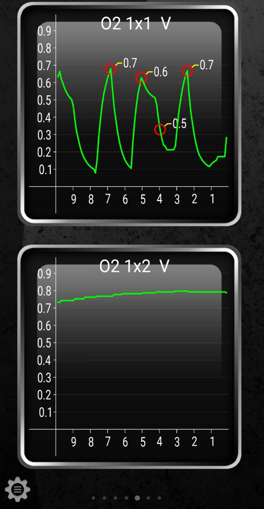

The CEL is not active with any codes. I am hoping these are all related to the same fix. Attached are some screen shots I gathered from Torque Pro. Any help would be greatly appreciated.

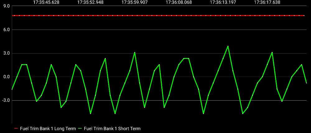

8 years 1 month ago - 8 years 1 month ago #23303 by graywave

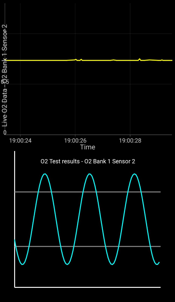

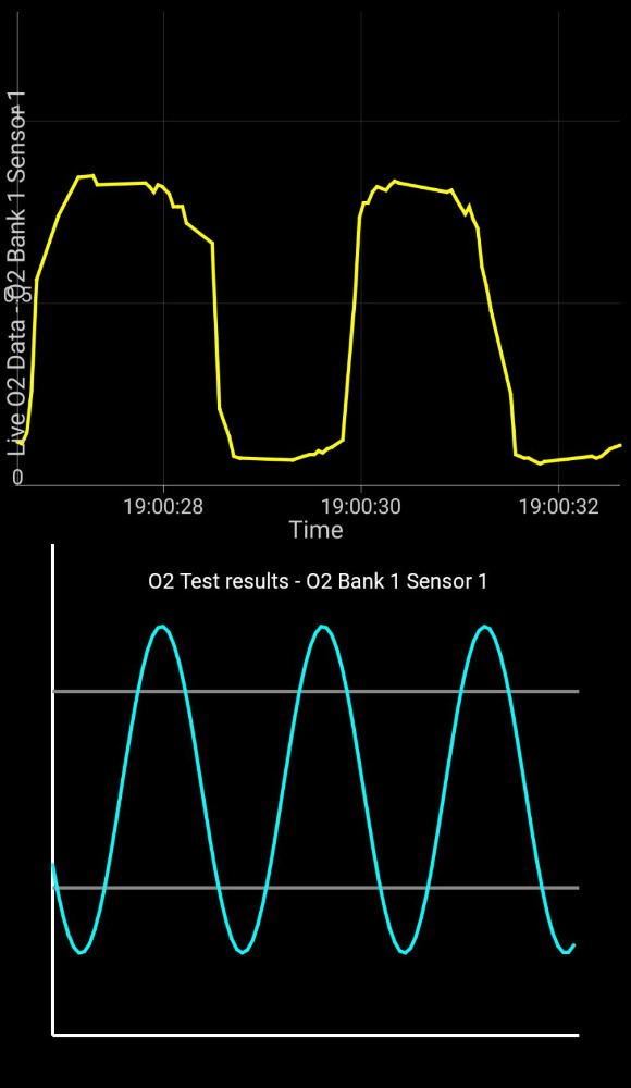

At a quick glimps your O2s are working. Sensor 2 should be a constant voltage at idle above .7v or over 700mv. Little less can be had without issues, such as 600mv but less than that and you possibly run into cat performance issues.
you will see sensor 2 dance around when your on and off the throttle. Sensor 1 should switch from around .1 or 100mv to .8 or 800mv. The high and low point is different from one sensor to another. Some will go as low as 10mv and as high as 950mv. Some will go as low as 150mv to 780mv. All depends on the sensor, the manufacture and other variables we won't know. As long as its switching from low to high usually indicates a functional sensor. There are variables to that such as the sensor switching to slow.
Those blue AC Sine wave looking waveforms you posted are only in a perfect magical world where everything is perfect. You won't see perfect AC Sine looking waveforms like that from an o2 sensor. Its fairly rare. Some do some don't
Those fuel trims look good too if those are at idle. Looks like its adding from 6-10% fuel. I usually like seeing less than 6% total but they say 10% and under is OK. Some PCMs won't trigger fuel trim related codes until they reach 30%! Is there only 1 upstream sensor on these engines?
Did these tests fail, or have yet to run? Does the O2 Sensor monitor show complete?

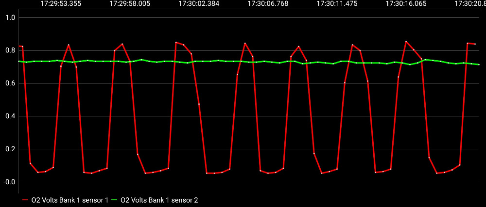

8 years 1 month ago - 8 years 1 month ago #23315 by frankiep77
graywave wrote: At a quick glimps your O2s are working. Sensor 2 should be a constant voltage at idle above .7v or over 700mv. Little less can be had without issues, such as 600mv but less than that and you possibly run into cat performance issues.
Yes, I believe those perfect blue sine waves are an example that Torque Pro gives for comparison to the actual. A better scan tool with faster response time might produce smoother results but these provide the general idea. This engine is an inline 6 with only one upstream sensor.
Attached are screenshots I took today at idle. Still learning how to use this Torgue Pro App but the graphs are pretty consistent with what I submitted previously. I wasn't sure if those were taken at idle.
I will crawl under this weekend and give another visual as I retest the pressure looking for the excessive rate of drop as you suggested.
Attached are the screenshots of the test results.

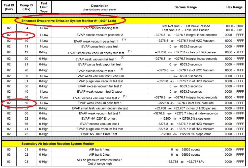

8 years 1 month ago #23334 by Tyler
Did some more digging into the Mode $06 data you're seeing. Something didn't jive - O2 tests failed with no codes? :huh: There should be some kind of pending code, at least. Finally dug up the GM master list for Mode $06 data on Class 2 networked vehicles (which yours is). Check out what TID $02 references:
gsi.ext.gm.com/gmspo/mode6/pdf/GM%20Clas...0data%20final_dm.pdf
The TID descriptions in Torque are wrong. :angry: Those failed EVAP tests now make perfect sense when talking about a fuel smell. No offense meant here, but this is why I hate Torque. :lol:
