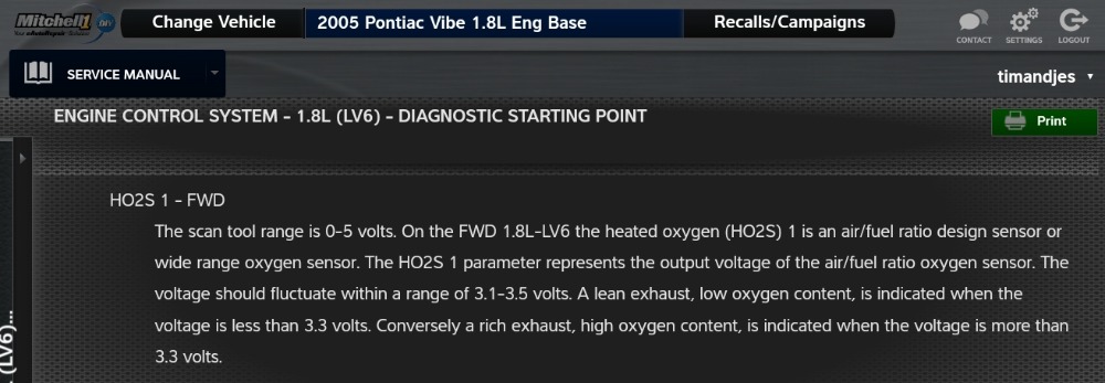

1 year 6 months ago #86725 by timothy.spencer
Wide Band AF Sensor from Mitchell1 accurate? was created by timothy.spencer
Take a look at this service data I saw in Mitchell 1 for a 2005 Pontiac Vibe.  Isn't this completely backwards?
1 year 6 months ago #86726 by Monde
We can try testing the theory by driving the sensor lean and rich.

1 year 6 months ago #86735 by timothy.spencer
Replied by timothy.spencer on topic Wide Band AF Sensor from Mitchell1 accurate?
Yes, that is a good idea. This is a 1.8 l Toyota engine. I also have a 2.4 l Toyota engine and I know it works the normal way where high is lean and low is rich. I can't imagine this little 1.8 l being different, but I can test it, to confirm.
1 year 6 months ago #86947 by Tyler
The part about the upstream air/fuel sensor normally reading from 3.1 - 3.5V is correct enough, yeah. The rest of it is pretty backwards.   I'm guessing the translation from Toyota service info to GM didn't go very well.
Should be: Higher voltage is lean, lower voltage is rich.

1 year 6 months ago #86951 by timothy.spencer
Yeah, I agree, something seems to have gotten lost in translation. I hope people out there who haven't been taught these things by Scanner Danner don't get off on a rabbit trail with that bad info.
