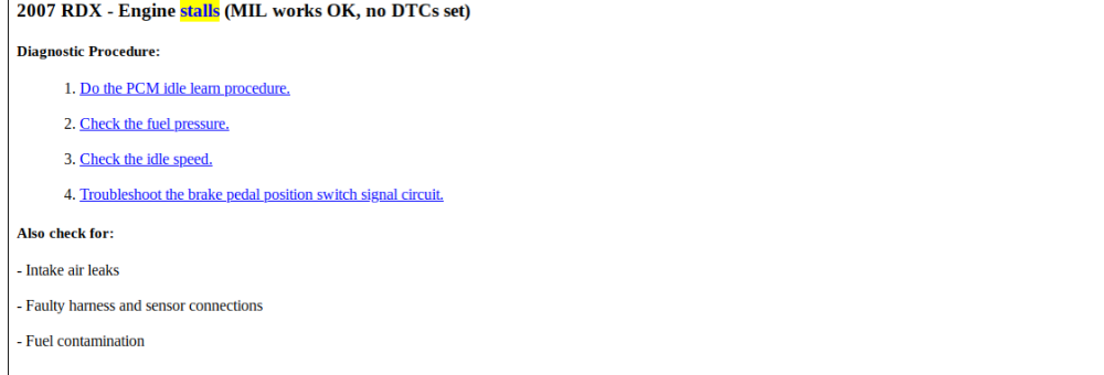

It's interesting you mentioned the brake circuit, 'cause I was digging in the SI for... anything? And found this:
Why would the brake switch factor in? :huh: For the lights, sure. The ABS would care. It's not a push button start.
