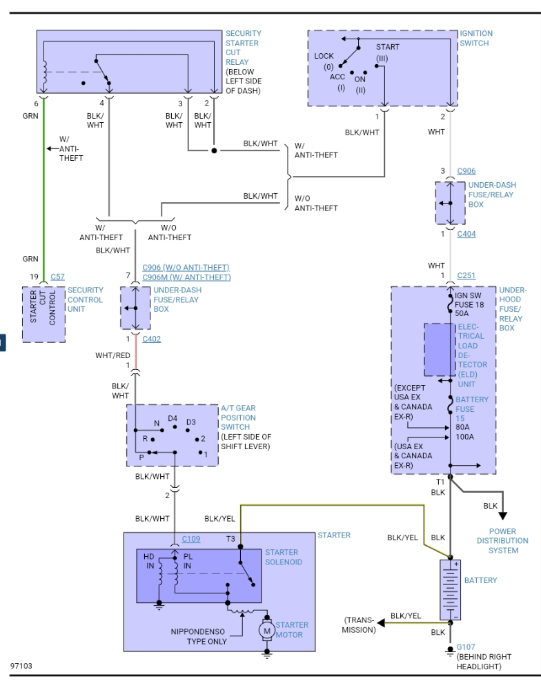

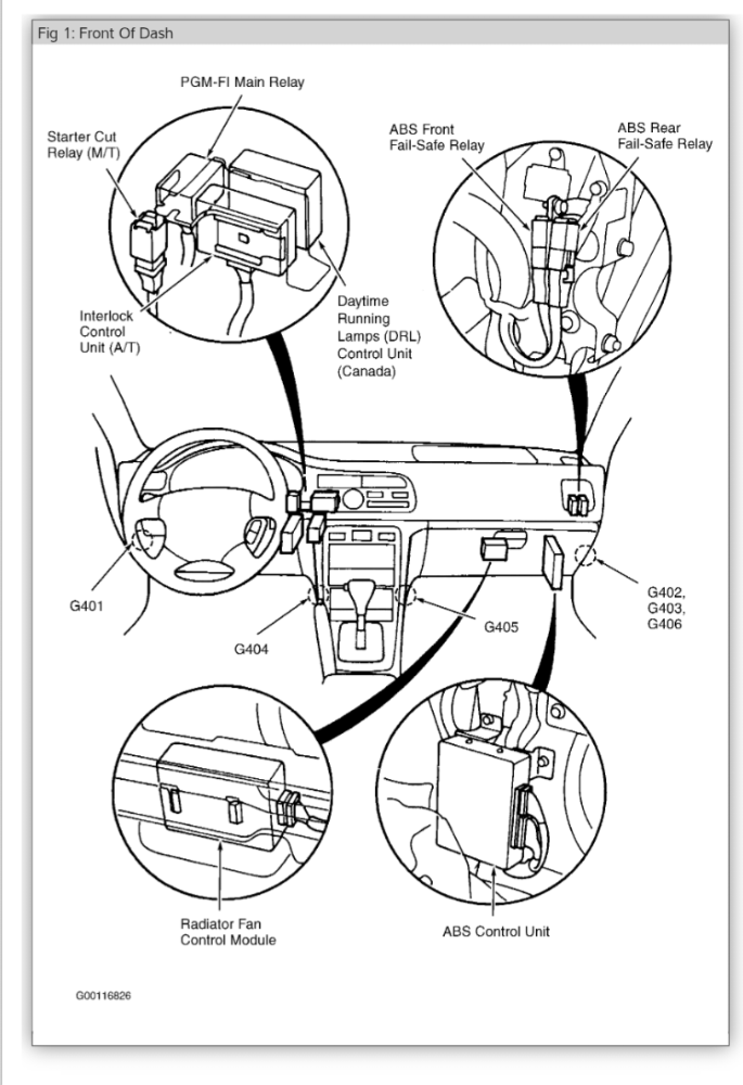

Engine will not crank, start. Replaced battery and ignition switch. Does this car have ignition relay and where is it ?
