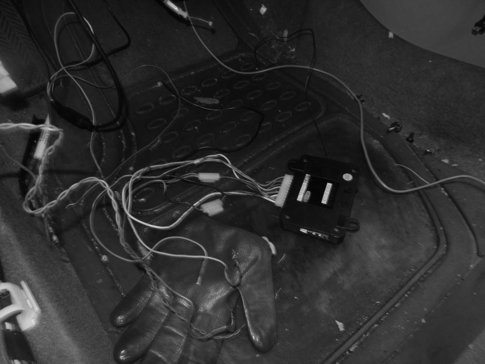

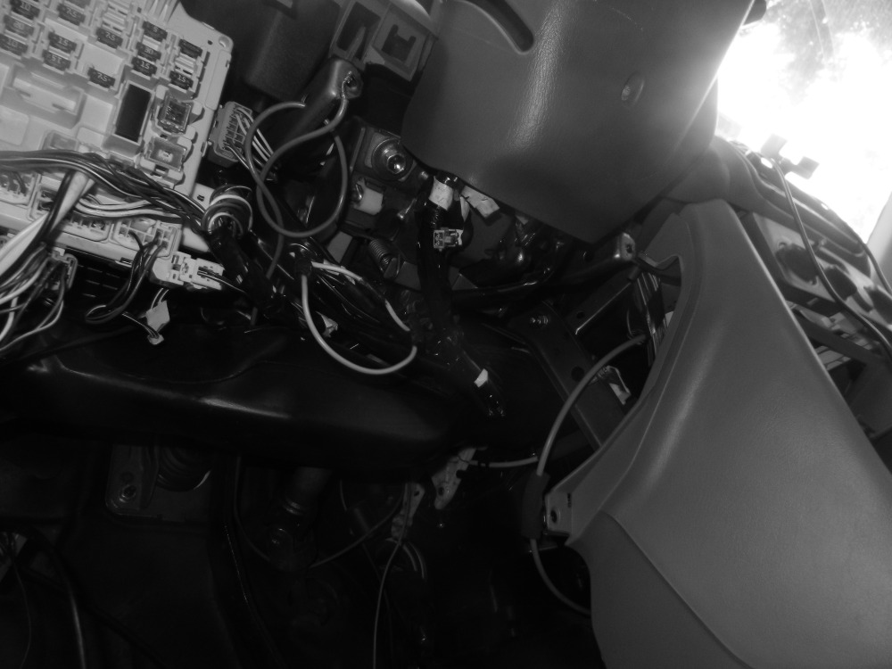

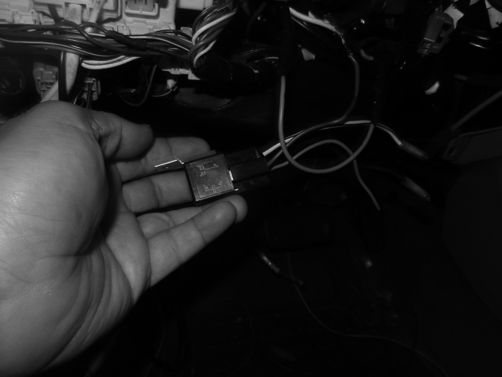

Test & discoveries:
What shut down the car's computer was not the fuel pump it was reading 50 lbs while cranking.
It was an after market alarm and remote system I never new existed. My foot hit a toggle switch on the foot panel and some how it was activated even though its wires where found cut off however the power pak and my foot trips the modules logic circuits.
All relays ohm and tested under load.
All fuses good not blown, except for three 10 fuses on inside the dash ; 2 inside engine fuse box; there is no power going through these three fuses, the filaments are fine.
No power from the load side of fuses on battery side terminals the ground side is good battery to pos+ lights up.
Crank sensor: ohm is 2000; cam ohm is 1045 ; on connector side no power from battery on both sensors; no injectors; no coils; no spark; no fuel pump action either, just crank.
reconnected both sensors back probed signal wire crank reads 2 for voltage ref; cam reads 000 in reverse polarity on the meter.
Bypass taps on both crank and cam signal wires no meter reading; while cranking the reluctance gears no RPMs readings while bumping ignition key.
Haynes wiring diagrams is all I got.

What shut down the car's computer was not the fuel pump, it was reading 50 lbs while cranking.
It was an after market alarm and remote system, I never new existed. My foot hit a toggle switch on the foot panel and some how it was activated, even though found 2 wires cut off; however the power pak and my foot trips the after market module's logic circuits into anti-theft mode shutting the cars fuel pump; no spark and no injectors.
All relays working, ohmed and tested under load.
All fuses good not blown, except for 3 10amps fuses; 1 fuse inside the dash ; 2- 10 amp fuses inside engine fuse box; there is no power going through these three fuses, the filaments are fine not blown. Paul, says in video, that these unblown fuses are not getting the power feed from the ground side of the computer implying no return power on ground side, of fuses?
No power, from the load side of fuses terminal, on battery side, the ground terminal of fuse does not light up when test light to bat neg so ground side is good; to confirm this test light to battery pos+ it lights up on the ground side terminal of fuses.
Crank sensor: ohm is 2000; cam ohm is 1045 ; on connector side; no power from battery on both sensors; this is a new symptom after cutting after market devise, from under dash board; no injectors; no coils; no spark; no fuel pump action either, just crank. coils still show power to connectors.
reconnected both sensors; back probed signal wire; crank reads 2 voltage ref; cam reads 000, in reverse polarity, on the meter no reference voltage it pulls down to 000.
Bypass taps, on both crank and cam signal wires simultaneously; no meter reading; while cranking the reluctance gears, no RPMs readings, while bumping ignition key no average volts.

Test & discoveries:
