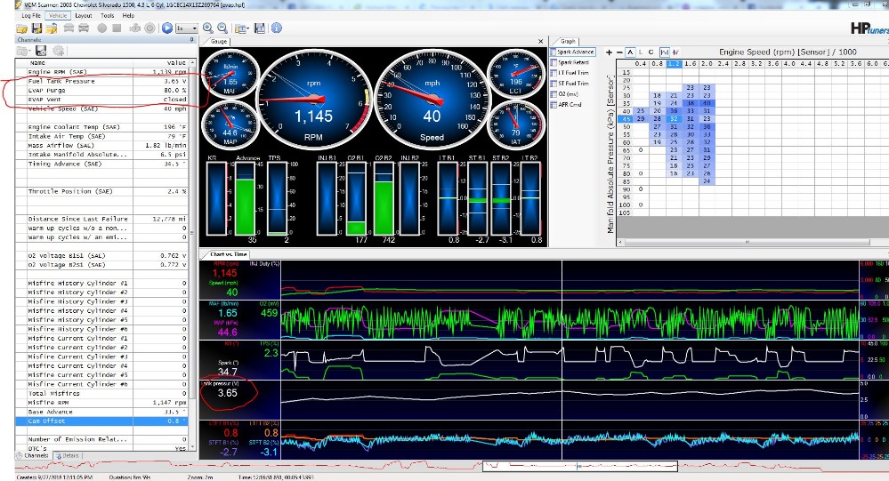

Hooked up HPTuners and did a few observations:
- Fuel tank pressure sensor works. 1.3V initial, if I open the purge valve it goes up.
- Previous item tells me that Purge valve works as well.
- Evap vent valve is showing always as Closed??? Turn ignition on, start engine - no change - still shows closed.
If I run a command to open the vent valve - it starts showing as Open, but I see no change in pressure. I hear the valve click, however.
When I drive, the tank pressure sensor voltage can go as high as 3.8V.
I opened the purge valve at idle and built some vacuum in the EVAP system, then I closed the purge valve and opened Vent valve and nothing happened - the vacuum was still there... Which tells that the vent valve is stuck closed, or the tube is clogged, but what confuses me is that the valve is showing closed all the time...
What do you folks think?
I'm not familiar with HPTuners - can you post some screenshots? If it's doing bidirectional testing, then it's obviously capable. :cheer:

Tyler, thanks for quick reply.
I rechecked the log file and looks like the initial FTP vas 1.4 V and when I shut off the engine it slowly returned to that value, so looks like the FTP sensor is working properly.
I agree that most likely there is a restriction in the vent valve related components. What got me confused is that the vent valve always shows CLOSED, even though its default state should be open. Whether it is closed or not - I do not know, but I will confirm it. I plan on checking the EVAP system this weekend - I will pull the vent valve and operate it out of the vehicle.
HPTuners has two components - PCM editor (edits all parameter, like ignition tables, fuel tables, transmission shift points, etc.) and Scanner (this is where you can read live data and send special commands). It is fully customizable.
On the screenshot below I highlighted the data I have added for EVAP testing, I also added the TPS chart on the right bottom side.
7 years 11 months ago #23546 by Bealio
Replied by Bealio on topic GM EVAP vent solenoid
Did this DTC set while you had this software hooked up?
Is the scanner software bugging out and somehow commanding the PCM to energize the vent coils ALL the time?
PCM provides the ground for the vent valve. Use a multi-meter or test light and see If you detect a ground on the white wire with scanner software connected. How about with the scanner software disconnected?

7 years 11 months ago #23581 by Tyler
Replied by Tyler on topic GM EVAP vent solenoid
I'm wondering if that EVAP Vent PID just isn't working correctly. :unsure: Like Bealio suggested, some circuit checks at the connector would confirm this.

7 years 11 months ago #23589 by superfragl
Replied by superfragl on topic GM EVAP vent solenoid
I think the issue should be resolved now.
First of all, the vent solenoid being closed all the time was just the incorrect interpretation by software (I already submitted the bug to tech support). It was actually open all the time and I confirmed this with test light.
Next I took off the vent valve and found it to be sticking in closed position.
And last - I checked the air flow through the vapor canister and and I felt like it is somewhat restricted. With the vent valve off, engine running and purge valve open - there was still vacuum building up in the system. I was not sure if it is normal or not so I went to the autoparts store and asked to take a look at the new canister - I tried blowing air into vent port and there was no restriction at all.
After replacing the canister and the vent valve everything works the way it is supposed to - once I open the vent valve - the pressure drops to atmospheric within a few seconds. If I purge the air and seal the system - the vacuum stays there and the value does not change at all.
