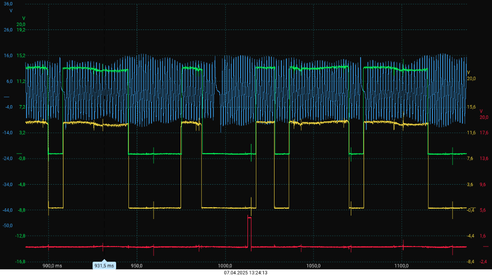

Hi erverybody, I please need a known-good waveform for a 2012 Porsche targa 997 3.6 litre 6 cylinder. At idle the whole bank 1 on this car is misfiring and too rich. Bank 2 is the complete opposite, it is too lean, but not misfiring. At higher rpm the fuel trims improve to nearly normal. I wanted to check the cam timing, but cannot find this car.
Thank you in advance.
Jutta
I have add a waveform, that I have made.
