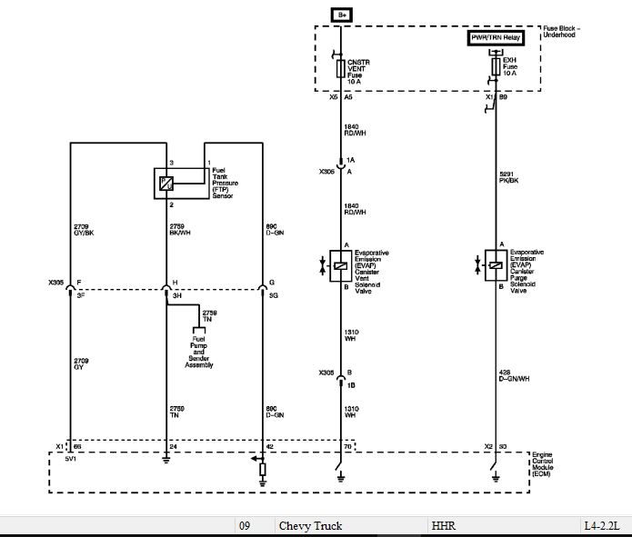

7 years 10 months ago #23736 by Paul P.
Replied by Paul P. on topic P0449
Here's a diagram, that fuse will have B+ with the KEY ON/Engine OFF.

Thanks for the diagram and the info about ghost voltage.

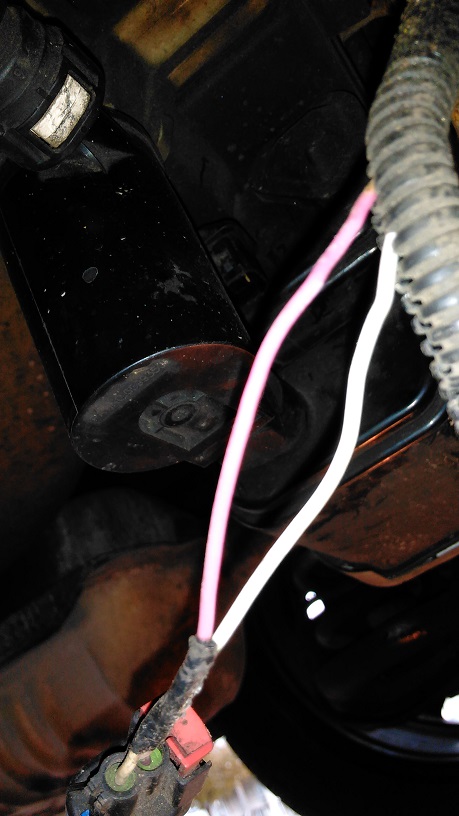

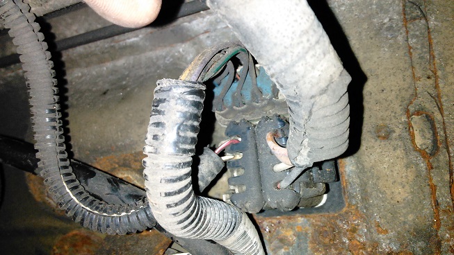

I took a look at the wiring at the solenoid and I see there's a short wire from the solenoid to a connector on the bottom of the underside. I back probed that connector and the one on the solenoid with the key on/engine off and found no current. Maybe I wasn't getting good ground so I'll try that again.
I looked inside the well where the spare tire is to see if I could find wires from that other connector but I didn't see any so I don't know where they are. I'll have to keep looking.
The picture shows the other connector. The solenoid connector is the lower left with 2 wires.

I was about to run a new wire using a better light when I noticed that the wire I thought was red/white at the solenoid connector is not red /white. It looks more like purple with no white at all. The other wire is white.
Have you ever heard of GM using a different color wire for power to the vent canister solenoid?

I pulled the wires out of the pigtail loom and found that someone had spliced a new solenoid connector to the pigtail. Probably came from a salvage yard. That's why it was not red/white at the end.
I removed the pigtail from the car and tested for continuity. There was none on either side so I replaced the wires. Now there is continuity.
I tested the body connector for continuity too with the engine off. There was none there as expected. I tested the body connector for voltage with the ignition on and there was current on the red/white terminal.
I removed the negative battery cable to clear the code then reconnected it and reinstalled the pigtail.
I started the car; the CEL is now off. It hasn't come back after 3 cold starts.
