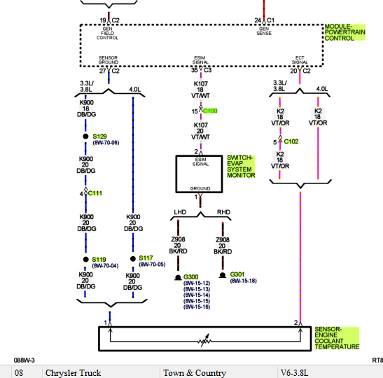

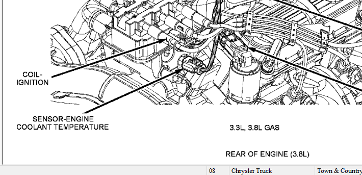

Before you change the ECT out, start the engine and unplug the ECT, the fan should start on High and youll probably set a pcode so long as that signal goes high.
Disregard the above statement, call me a liar!
Your ECT has two wires, Dark Blue with Dark Green tracer(Sensor Ground) and a Violet with Orange tracer(Signal)
See if the PCM will turn the fan on by backprobing the Violet/Orange wire and jumping it to Ground.
You may set a code, but the fan should run because the ECM thinks the engine is hot.

Finally able to try this out. Back probed ECT and jumping violet/ orange to ground did turn the fan on.

Replied by Paul P. on topic 2008 Chrysler Town & Country Radiator / AC Fan
That's good news, change out the sensor and you're good to go!

It would be wise to check your sensor ground as well, unplug the sensor, paperclip the sensor signal wire to the sensor ground wire.
Fan turns on, you're wiring integrity is good, replace the sensor!
