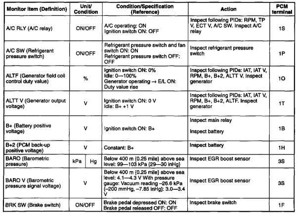

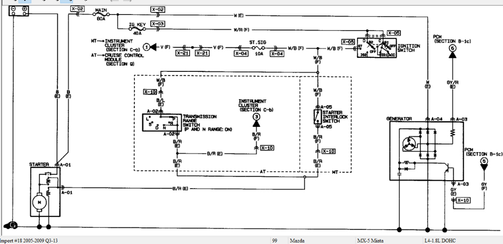

15-19 volts is not good. The Field Coil on your Alt is controlled by the PCM through the Gray w Red Tracer wire. It is a Pulse Width Modulated signal, the PCM measures it as Duty Cycle. The more electrical load required from the Alternator the higher the PCM raises the Duty Cycle.
If you are able to measure the Duty Cycle with a DVOM capable of this, you should have 0% KOEO.
With the engine running this value should start increasing as you turn on more electrical loads.
Here, I am just trying to prove your PCM isn't commanding a 100% duty cycle.
Try unplugging the Gray/Red at the ALT and checking output voltage for a change.
As for the Positive side Volt drop, you can divide those numbers by 2, if you checked drop from BAT+ to ALT Output. You also dropped the starter POS at the same time if that's the case.
Heres a few diagrams for reference.

Granted, the voltage drop is a little high here.
My first concern would be to make sure the PCM isn't commanding a high duty cycle at idle with very little load.Then as load is increased at idle the duty cycle should rise. I want to verify the PCM is functioning properly before condemning the Alternator.
If the PCM is OK, then I would suspect the Alternator.
Also, you can try putting a booster cable (known good) from Alternator output to B+ and do the duty cycle checks, AND recheck your output voltage to see if it improves, if it does improve and holds steady at low and high load ranges, you can suspect your positive side wiring at this point, which I have yet to believe this is an issue.
