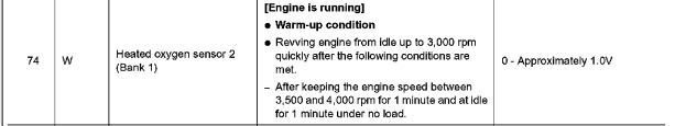

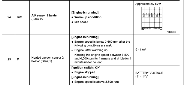

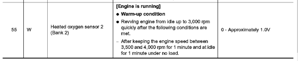

Needed some info for 05 nissan quest 3.5L afr sensors? there are 2 upstream afrs, what is the normal voltage range of them? than the 2 downstream o2 sensors are they used to fine tune the fuel control,or just to see the health of the cat?
7 years 10 months ago #23852 by Paul P.
Upstream is for Fuel Control, Downstream is for Catalyst under normal OP conditions.
