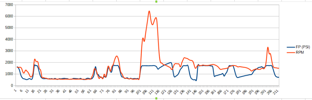

Here's a graph of RPM Orange vs Fuel Pressure Blue where your hesitation occured, so I still wont rule out some type of fuel problem.

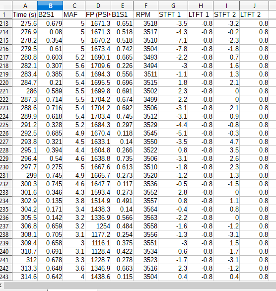

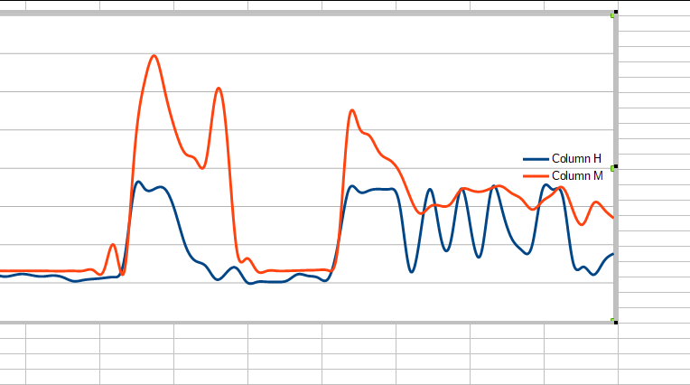

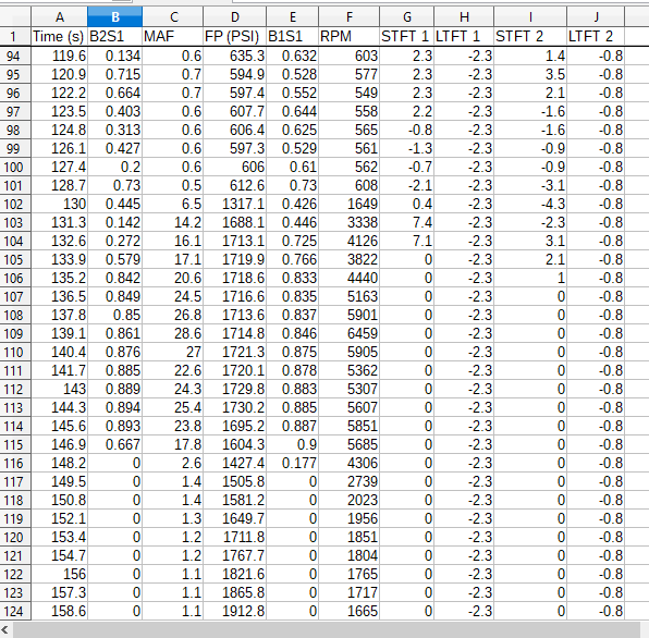

I hate to be a pain, but the idle, 1500, 3500 need to be in park. just hold as best that you can! Idle and 3500 are the most important.
The WOT test sent the O2's rich so fuel delivery from the pump looks good.
Your Fuel trims are within 5%, which is very good. Except for the odd spike where Fuel pressure blips
Bank 1 LTFT at idle is -1.6, high RPM -2.3, so it's actually subtracting fuel, keep in mind these a very tight fuel trims that look pretty good.
Things that I don't like is the fuel pressure ups and downs.
If you're gonna install a new MAF. Post some more data and switch the Mass Airflow rate to Grams/ Second, keep the Fuel Pressure in PSI
Overall with the data I reviewed nothing blatantly stands out, other than what your fuel pressure was doing during the hesitation.
Let Me know which MAF you are using in the test data
Also, check your Mode 6 data on your bluedriver and look at the misfire monitors, are there any? if so post which cyclinders
I don't like what the Fuel Pressure is doing here on the WOT test after max rpm starts to drop

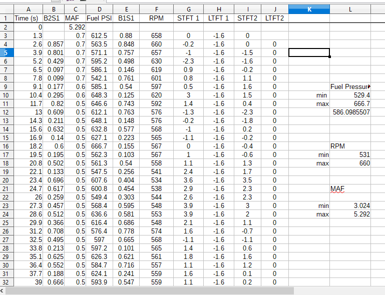

Just some more stuff I see....
You RPM at idle is isnt very steady... MIN 531, MAX 660, +/- ~65 RPM
Fuel Pressure at idle same thing MIN 529, MAX 666
The Idle on this engine seems low to me.
MAF readings seem low too
Never stop Learning.

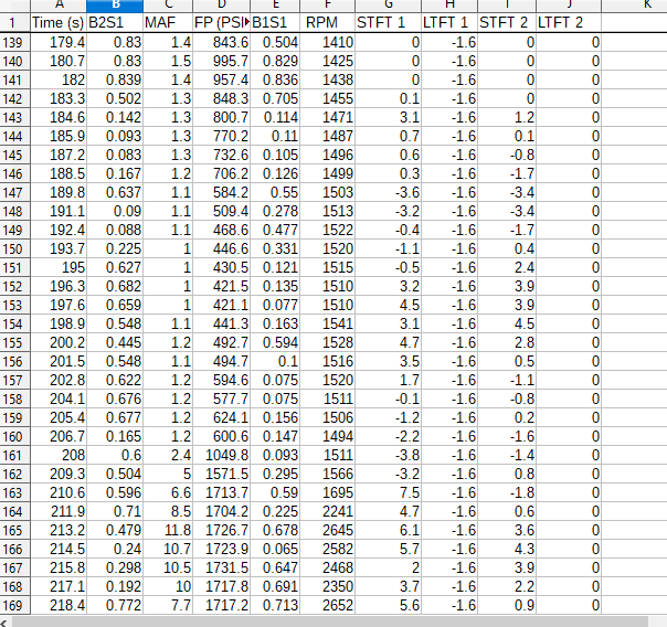

After looking at all the data, which for the most part looks pretty decent( nothing stands out like a sore thumb), a few things I notice.
1. Possible Sluggish Pre-O2 Sensors. A scope is required to verify this. This will cause hesitation.
2. The Calculated Load seems unreasonably high at idle. (This is usually a MAF issue)
3. The Fuel Pressure Sensor is sending the PCM erratic info. Its either telling the truth, which would mean a fuel system issue, or it is not providing the correct info to the PCM. This will cause hesitation, rich/lean conditions.
4. The Idle seems a little low, which suggests vacuum leak on a MAF engine, however the fuel trims Do Not support this. A good throttle body cleaning may be in order.
5. The Idle RPM varies 130 RPM, which is quite a bit, it's "hunting" up/down. Fuel Regulation, Vac Leaks can cause this.
6. The fuel trims DO support an under-reporting MAF sensor.
It should be noted, most of the data that was recorded was missing either some LTFT info and STFT info, maybe a limitation of the Bluedriver and this makes it difficult to tell what the PCM is doing for Fuel Control.
