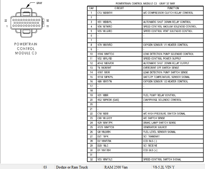

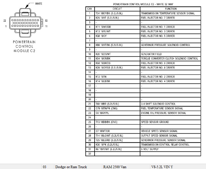

7 years 10 months ago #23899 by Paul P.
Replied by Paul P. on topic Transmission Electeical
Here is you Alternator Wiring Diagram.
The White wire with the Dark Blue Trace goes to pin 25 of the ECM Connector 3 (Gray)
The other wire the Dark Green goes to Pin 10 of the ECM Connector 2 (White)
Neither of these two wires go to the tranny.

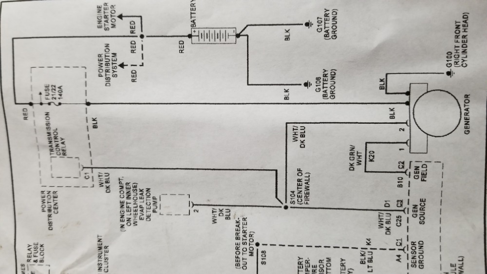

7 years 10 months ago #23902 by Jrogers0229
Replied by Jrogers0229 on topic Transmission Electeical
This is the diagram I am using. Everything matches up so I am assuming it is correct. I paid for the service to download so it should be. Anyway the wht/drk blu wire is the one in question. Comes off the plug for the alternator and goes to the pcm and the trans relay. I am super confused since I have been looking at this stuff for weeks. Need a new set of eyes maybe. Thx

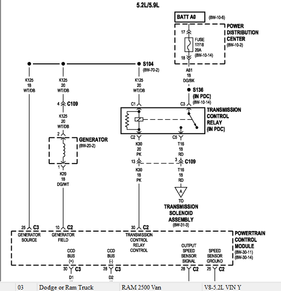

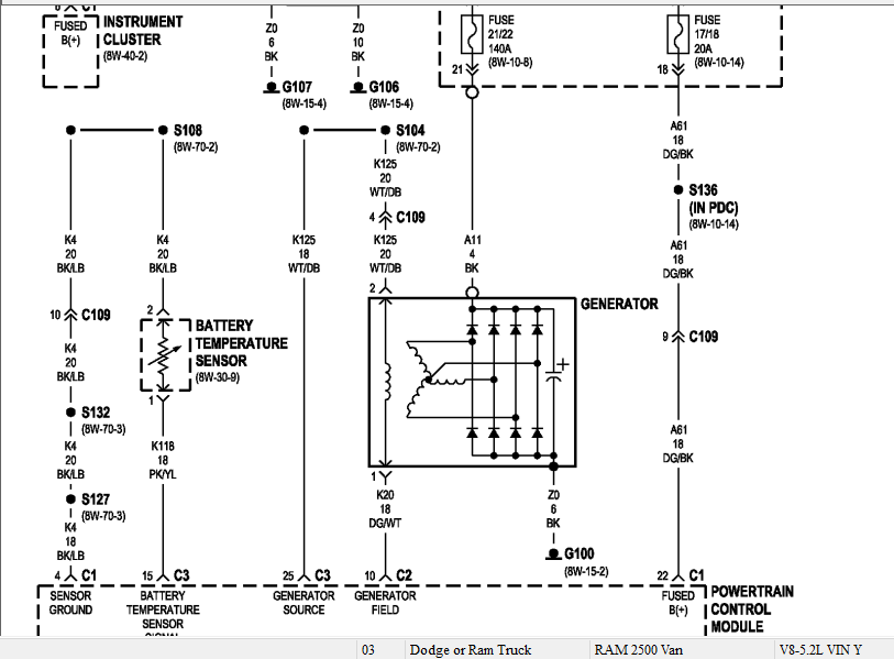

7 years 10 months ago - 7 years 10 months ago #23904 by Paul P.
You can get all your wiring diagrams here as well.
www.bbbind.com/free-tsb/
The wire in question according to my info goes to Pin 25,PCM Gray Connector 3.
AND, YOU ARE CORRECT, it does provide control power to the trans relay it splits off at Splice 104 which is located...
Wow thats poor on chryslers part not to show that on the Generator diagram, but they did label the splice and reference the other diagram

7 years 10 months ago #23911 by Noah
Replied by Noah on topic Transmission Electeical
Seriously, a dotted line on the splice would have least you know there's more to see...
Thanks for coming though with those diagrams :)

7 years 10 months ago #23933 by Paul P.
Does that wire have power on it after the relay or does the relay require that wire to have power on it to work and then the pcm will see the 12v?
That wire has 12v on it to the relay. The relay does require power on it to work. The PCM provides the ground path( the pink wire) to energize the relay. This is the 'Control' side of the relay.
Does the alternator need to see power on that wire to turn on and off?
Yes, it needs 12v from the PCM pin 25 connector 3. The PCM will use the other wire the Dark Green/White trace to 'energize' the alternator.
I think both the trans and the charging issue are connected
They most definitely are connected.
The transmission relay might be misleading you depending on how your doing your voltage checks.With the key on youll see 12 v at the relay for the WH/DB wire, but you may or may not see 12 volts on the pink, depending whether the PCM has provided a path to ground.
