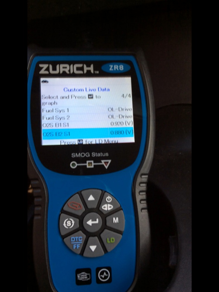

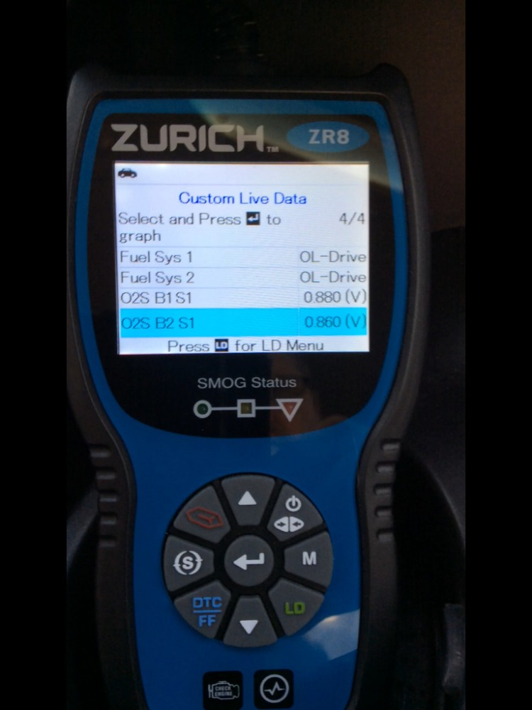

This morning I followed Weycraze's advice and warmed the truck up to normal operating temperature. I went to the mall parking lot. I put the truck in "Low 1" and floored it as long as I could. I did the WOT test twice. The videos are not viewable because I couldn't keep the scanner in frame but here are two screen shots of the results.
WOT test #1
WOT test #2

Good WOT Test
Good LTFT at idle.
Good LTFT at 1500 & 2500.
Watch your LTFT and STFT's at exactly 13 sec in the 2500 vid, your trim STFT & LTFT are cancelling each other!
Looks to me like a PCM RE-Learning its Fuel trims!
Confirmed Fix!
Feel free to monitor your LTFT over the next day or 2, they should balance themselves out.
