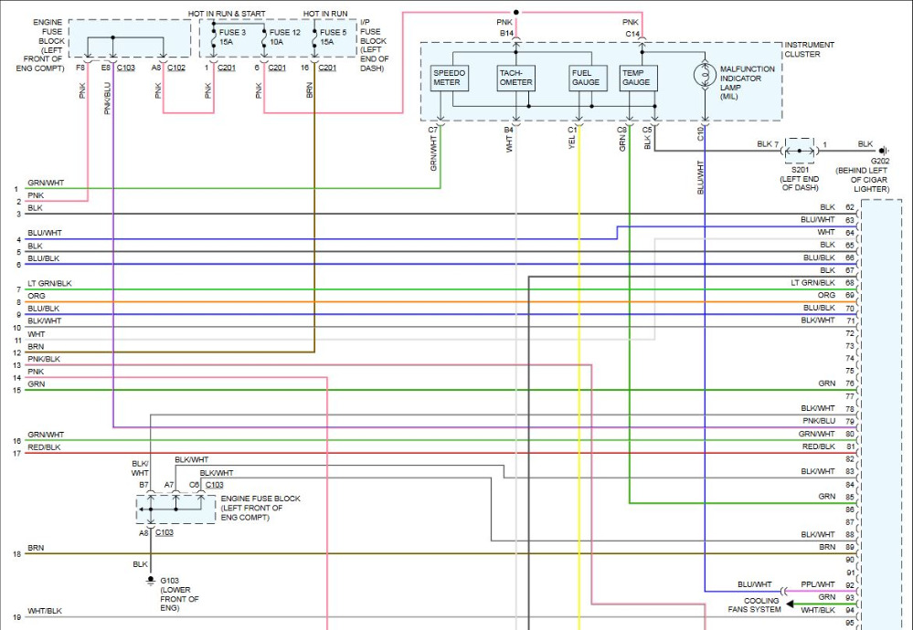

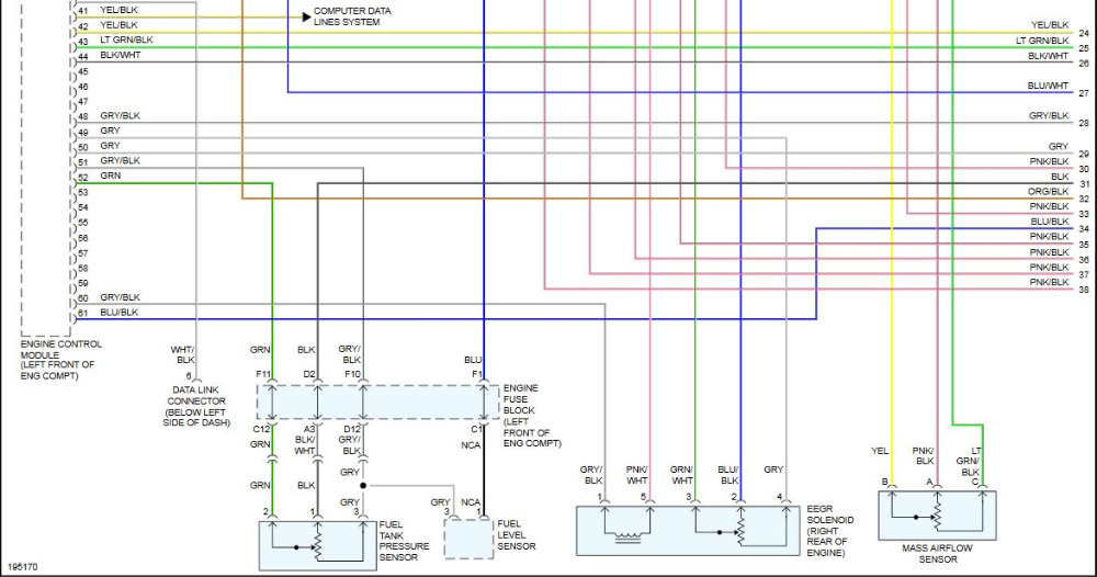

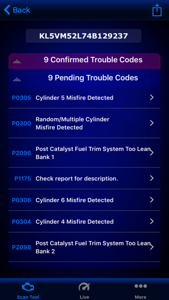

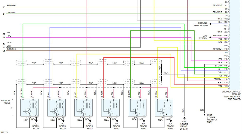

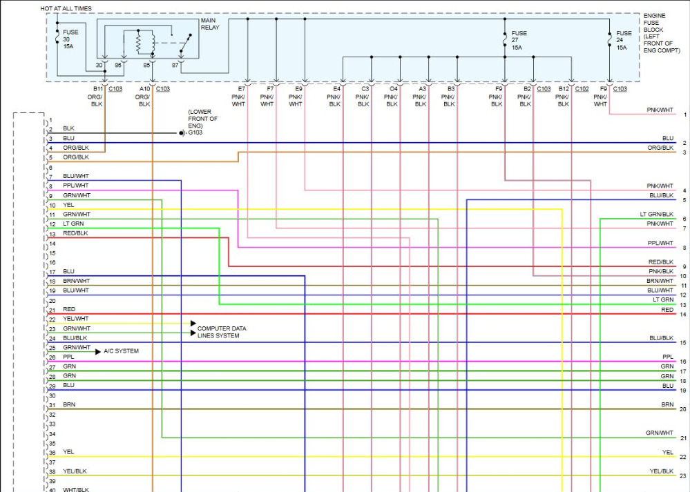

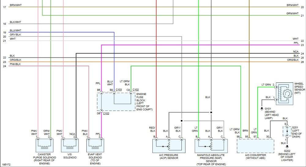

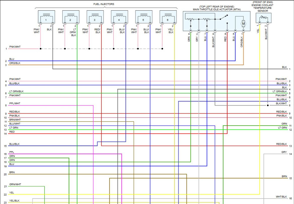

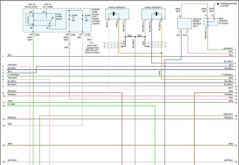

I have a 2004 Suzuki Verona 2.5 with a no start issue. I did discover that the 12v and ground in the coil pack wires are shown to be common. If unplugged from the main wiring harness they are not. So I know the problem is from the computer to that point of the harness. I can’t find any wiring diagram for that car specifically tied to the coil pack/fuel injector wiring harness. I will attach all stored codes that I was able to pull up also.

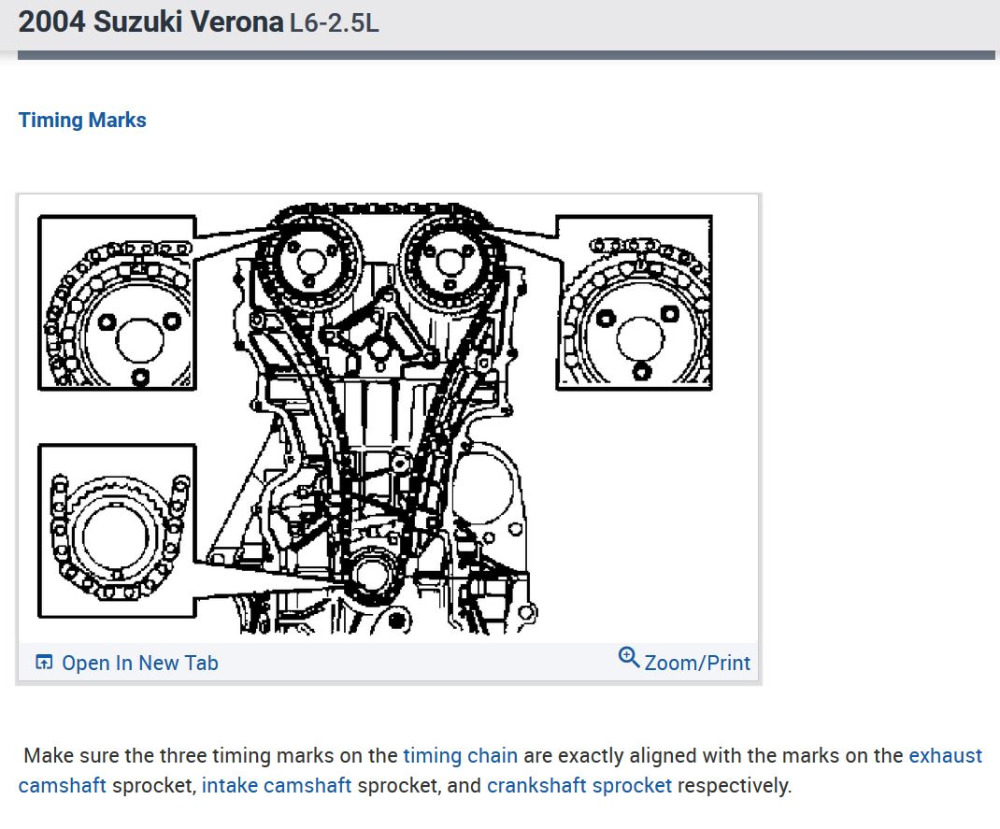

Anyway I can get a diagram of the timing mark placement? I have two diagrams one showing different from the other?? One diagram shows the cam marks to be at 10&2 and the crank and 6. The other says both cams need to be at 12 and the crank at 6. Either way, the car at #1 TDC the timing marks aren’t either. So the car is out of time and need to confirm which timing is correct. Tyvm
Tim
Tim

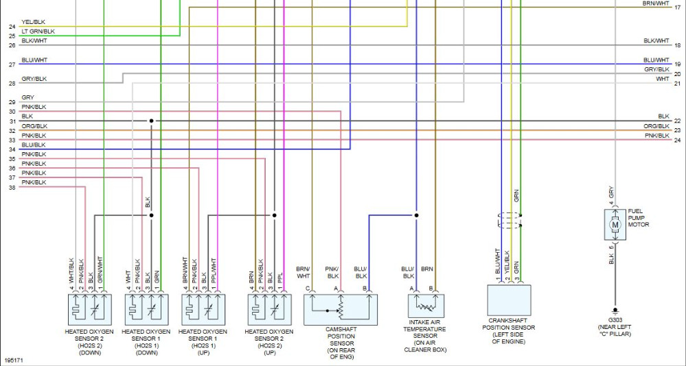

Can you tell me what the resistance value is for the cam sensor? I’m reading a 0.00 value.
