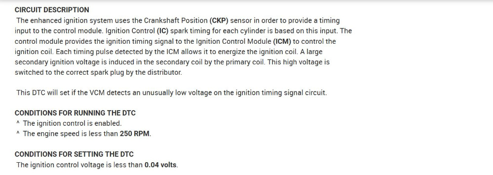

The pass-lock system will disable the injectors after 1 to 2 seconds. It will start, then stall. It does not disable spark. Do you have spark? Do you get the "Start, Stall"?
I ask because security codes for pass-lock are B codes.
P1361 Is an ignition code.

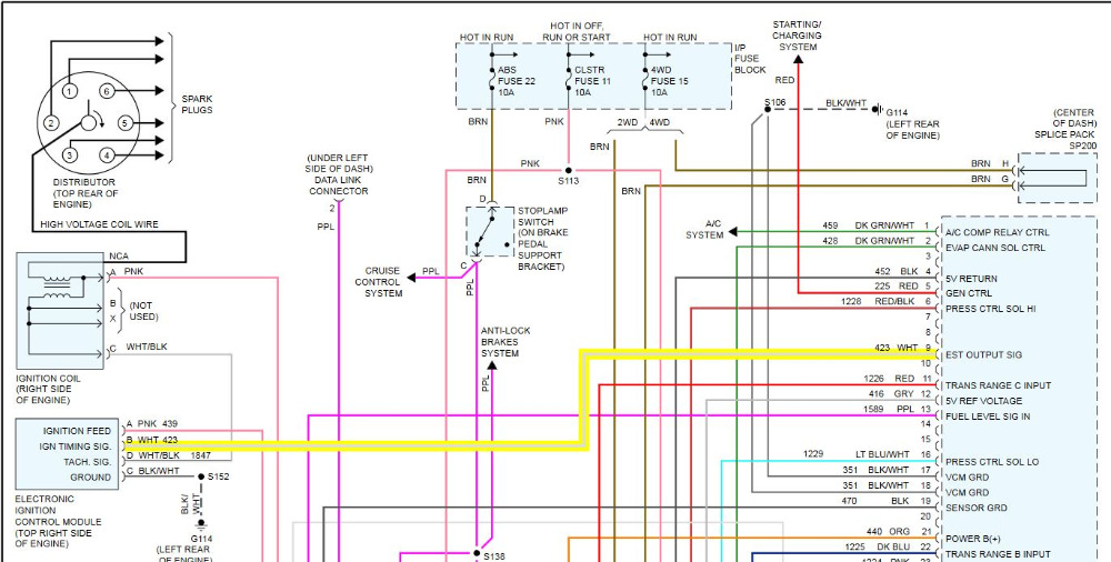

The 2.5 volt regardless of key position. Which wire is showing that? And what are the other two during this time? (3-wire right?)
Don't be a parts changer!
- JoesAutoElectric
8 years 4 days ago - 8 years 4 days ago #24325
by JoesAutoElectric
Replied by JoesAutoElectric on topic Looking for some direction 2000 Blazer
Hey Paul! Ok, so three wire sensor. RED/white - spec is over 10v Org/blk ground and Ylw is the sensor signal which is the the one reading the 2.5v constant with the new passlock sensor. Yes it is OEM.
