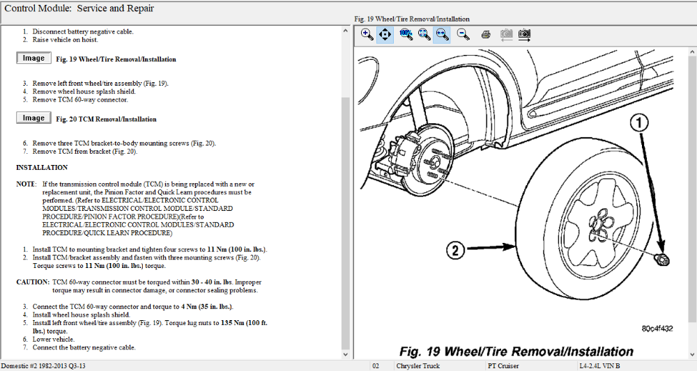

According to AllData, you are required to perform a Pinion Factor( for the speedometer) and a Quick TCM Re-Learn. Not quite sure if the Vantage can do that.
