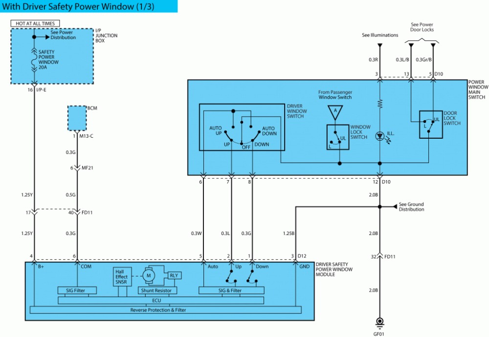

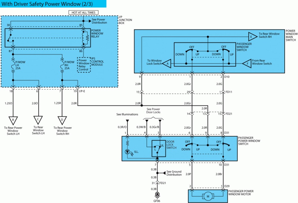

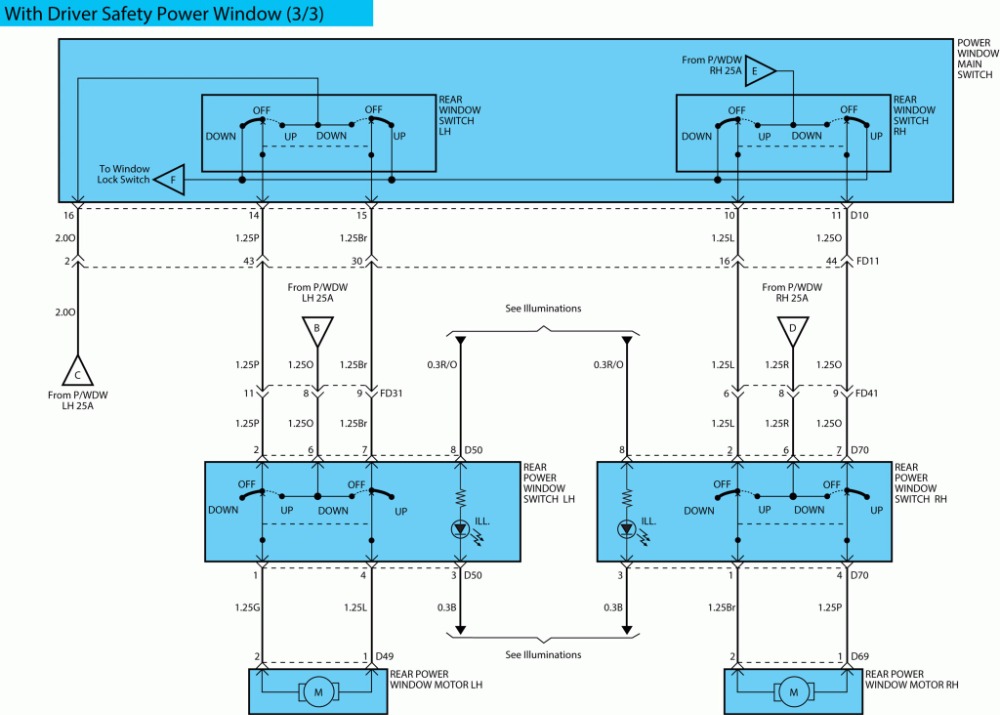

May I please ask for a wiring diagram please?
God keep blessing you,    please I'd like to ask if anyone is kind to provide me a wiring diagram for a 2012 hyundai tucson 2.4 L 2 wd,  gray,  Im in need to see the power windows system please.
passenger front wont go down but it goes up and right rear wont go either up or down.   thank you in advance,
1 year 6 months ago #88736 by Noah
Replied by Noah on topic asking for wiring diagram
These are from O'Reilly's First Call website.

1 year 5 months ago #90914 by mil.7.on.auto.diagnostics
Replied by mil.7.on.auto.diagnostics on topic asking for wiring diagram
Thanks for wiring diagram, I was able to find out the issue with vehicle. windows's master switch was faulty, since it had a bid voktage drop when passenger window going down was press down.   Thank you
I did a seprate load test on the wire itsef to make sure only switch is needed.
