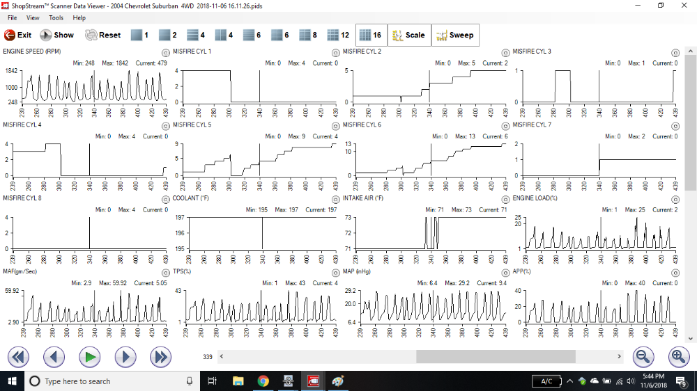

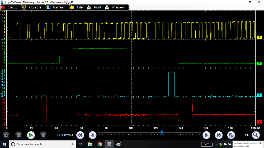

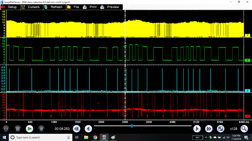

This must be the week of really strange things coming in the shop. I had a customer bring in a 2004 Chevrolet Suburban 6.0 4x4 with 155,00 miles. Customer put a new GM throttle body on it. When towing or backing up it will intermittently stall or almost stall. I scoped the crank, cam, ign coil 1, injector 1 and you can see there is a random injector pulse that happens some times. Any idea what is causing this? Fuel trims are +-3% on both banks so I doubt its a fuel or vacuum issue. I also smoked the intake just to make sure and saw no viable leaks. Show .040" which is usually normal for an intake from what I have seen. In order to replicate the issue I have to keep taping the throttle or hold it at an rpm in rev then quickly let off. I also included a screenshot of the data pids. It only shows misfires when you let off the gas quickly. Keep in mind, none of this happens while moving, this is all with the brake on in gear. It also has new ac delco spark plugs.

I would do a close inspection of the CAM sensor pattern. I've seen this kind of issue on the Honda Fit which has 8 coils[4cyl] when there is interference from a coil causing an induced pattern in the CAM sensor wiring . Every now and then the interference cuts the cam signal in half and the ECU thinks it's already time to inject for the next cylinder.
Another option if it is chain driven is wear/"stretched" cam chain and the slack only causes issues when the engine is slowing down.

Look at cam/crank relationship under acceleration and deceleration. Do a crank relearn.

I like Juergen's suggestion of doing the crank relearn on the scanner. Recheck for misses and symptoms afterwards. Make sure to tick all the boxes (parking brake on, engine temp, ect) when doing the relearn so it doesn't bounce you out.
I'd be very suspicious of the crank sensor itself, despite the lack of codes. They rust jack in their bores and cause all kinds of issues. Never had one come out cleanly - they ALWAYS break off. :lol: If you decide to replace it, bump your labor time a bit to allow for extraction.
What I really don't like is how the peaks of the cam and crank signals seems to waver.
You can see it in the zoomed out shot. Does the sensor supply circuit show the same pattern?
