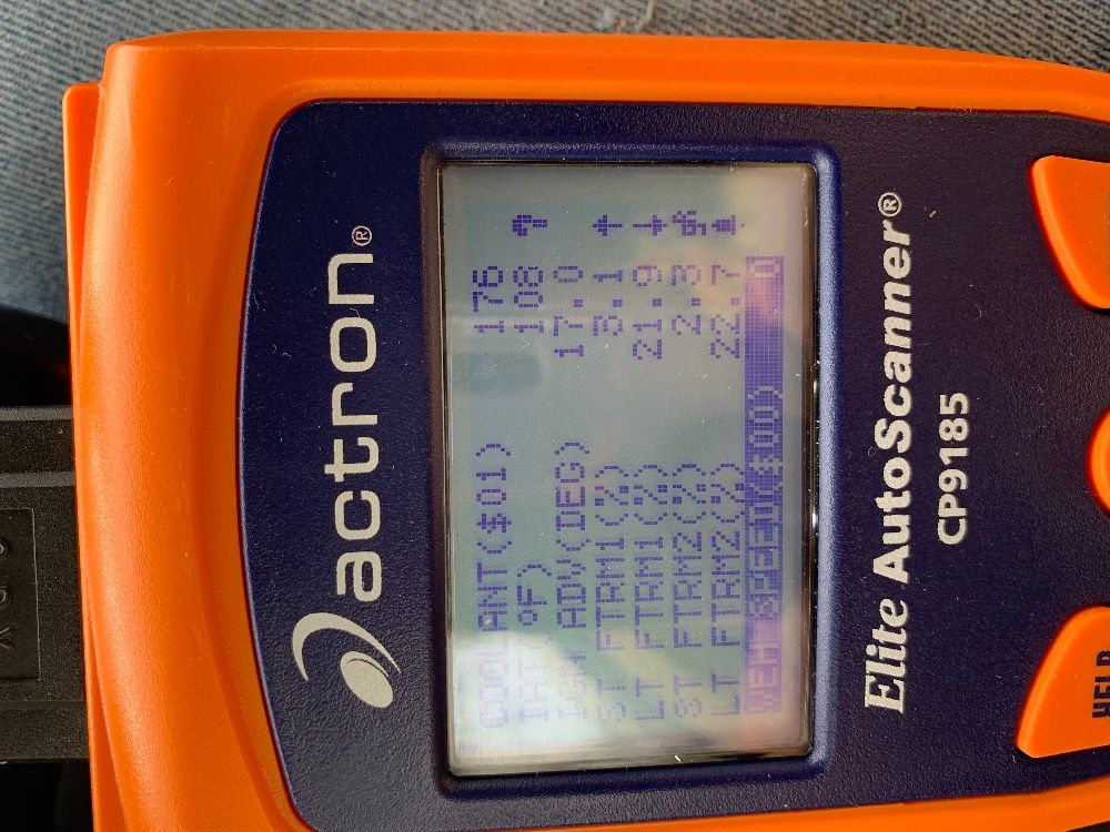

2007 Lexus IS350. Pictured is a screen shot of my scan data of the fuel trims after I replaced a Bank 1 downstream O2 sensor due to a P0137 code. What are the Short Term and Long Term trims telling me here? Can anyone lead me in a proper direction? Currently no codes but I think something is wrong. I don’t want to have to replace the entire “one piece” exhaust system for a bad converter if that is what this is telling me. BTW 114K miles

Replied by chief eaglebear on topic 2007 Lexus IS350 fuel trims question
fuel trims at 2500 and WOT might give a better picture
o2 response tests might be in order also where are the millivolts ranging from 100 to 900 mv

You're definitely looking at a lean condition. If it hasn't set P0171 and/or P0174 yet, it will soon. :lol: Lucky for you, since both banks are running equally lean, you're likely looking for something that'd impact both.
Before we go wild with diagnostics, were you doing any repairs under the hood? No insult meant, it's just easy to leave a hose off during repairs and end up with fuel trim issues. FYI, nothing you were doing with the downstream sensors or the catalytic converters will cause this. ;)
Standard fuel trim theory applies. When was this reading taken? If you saw these numbers at idle, raise the RPM to 2500 and check again. If they're significantly better, you're looking for a vacuum leak. If they didn't improve much or got worse, you're looking for a fuel delivery issue.

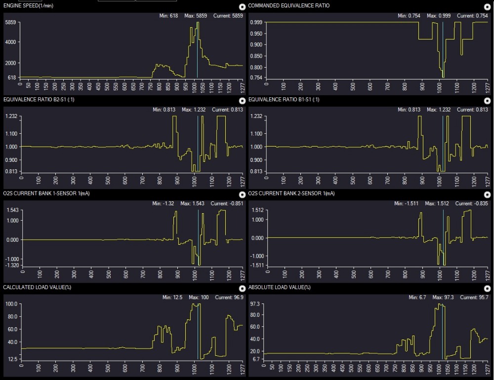

7 years 11 months ago - 7 years 11 months ago #24571 by Tyler
Replied by Tyler on topic 2007 Lexus IS350 fuel trims question
You can skip a TON of fuel system testing by doing a WOT O2 test. ;) In this case they're air/fuel ratio sensors, but the idea is the same.
The principle is to accelerate through 1st and 2nd gear at wide open and observe the upstream sensors. They should show rich. If they do, the fuel system is capable of keeping up with high demand. If they don't, then we dig into inputs (MAF), pirate air, and fuel delivery.
On this IS350, you're going to see the upstream air/fuel sensors represented by current data PIDs instead of O2 sensors with a 0-1V range. Not a problem. ;) Negative current is rich, positive is lean. I don't have a WOT run from an IS350 in Global data, but this is one off a newer Highlander. The data will be very similar.
Ideally, both upstream sensors will show -1 mA at wide open. Equivalence Ratio PIDs will hopefully show .900 or less.
You can also observe Calculated and Absolute Load under the same conditions to gauge engine breathing and air measurement issues. Both should clear 85% at wide open when close to redline. Low Load indicates a breathing issue (unlikely since you noted the engine has good power), or a measurement issue (more likely, because of the lean trims).
