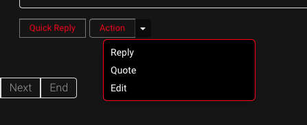

Also with regard to the correction you typed - there is an 'edit' option at the bottom of the thread after you post it
