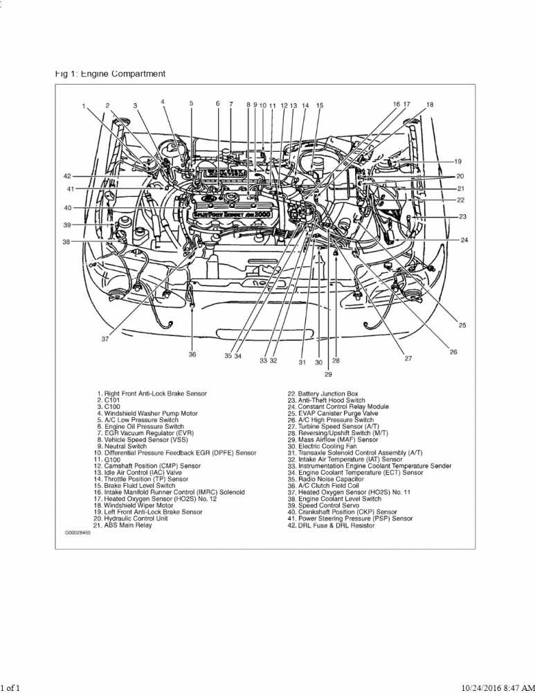

:PO340 )CAMSHAFT POSITION SENSOR. I HAVE A 2000 FORD ESCORT SE WITH A 2.0 S/P 4 CYLINDER ENGINE. CAN SOMEONE TELL ME WHERE THIS SENSOR IS LOCATED ON THE CAR? I WRITE IN CAPITALS BECAUSE IT'S EASIER TO SEE .ALSO WHERE CAN I FIND A GOOD ENGINE DIAGRAM OF THS CAR .TELLING ME WHERE THESE SENSORS ARE LOCATED.

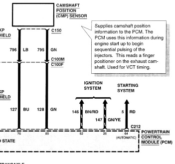

Hey John! Just wondering, would it help you to see the replies if they were in capitals?
My usual source for wiring diagrams is the BBB Industries site , completely free, and has pretty good coverage. Sensor location information is tougher... Honestly, I use Google Images :blush:
Anyway, I looked up your Escort and found this:
The diagram doesn't give a specific location, but you know it's associated with the exhaust camshaft, so that's a start. Plus, the wire colors can help you distinguish the camshaft sensor from others.

sensor locations

Thanks for the print I found the sensor and will work on it next week when I'm off Thank you very much for your help
