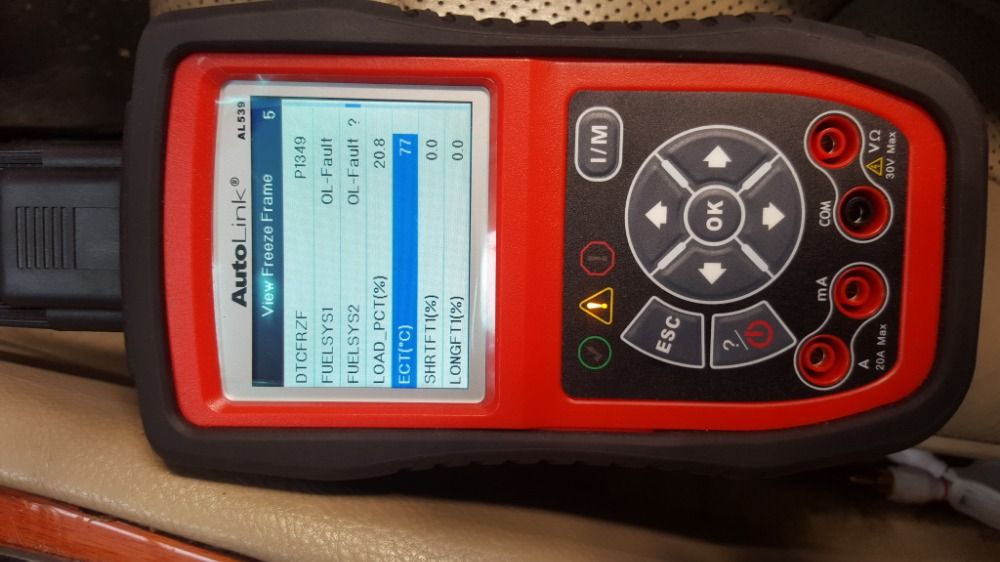

Fault codes are P1349 bank 1 VVT malfunction and P1354 regarding VVT on bank 2.
I have had our mechanic check cam timing after clearing fault codes and checking PWM at 22% at idle at the VVT solenoid.
Resistance of both solenoids is around 8 ohm.

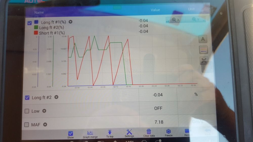

After joining this forum I have been paying more attention to fuel trims so took a reading at 2500 rpm and idle - this scan tool can
only graph 3 items at once. Only bank 2 was showing long term fuel trims. The short term fuel trim for bank 1 was bouncing up and down to 20%. At idle everything dropped to zero.
After a while a "low oil level" warning came up on the dash. I'm wondering if it is actually a blockage problem with the oil system.

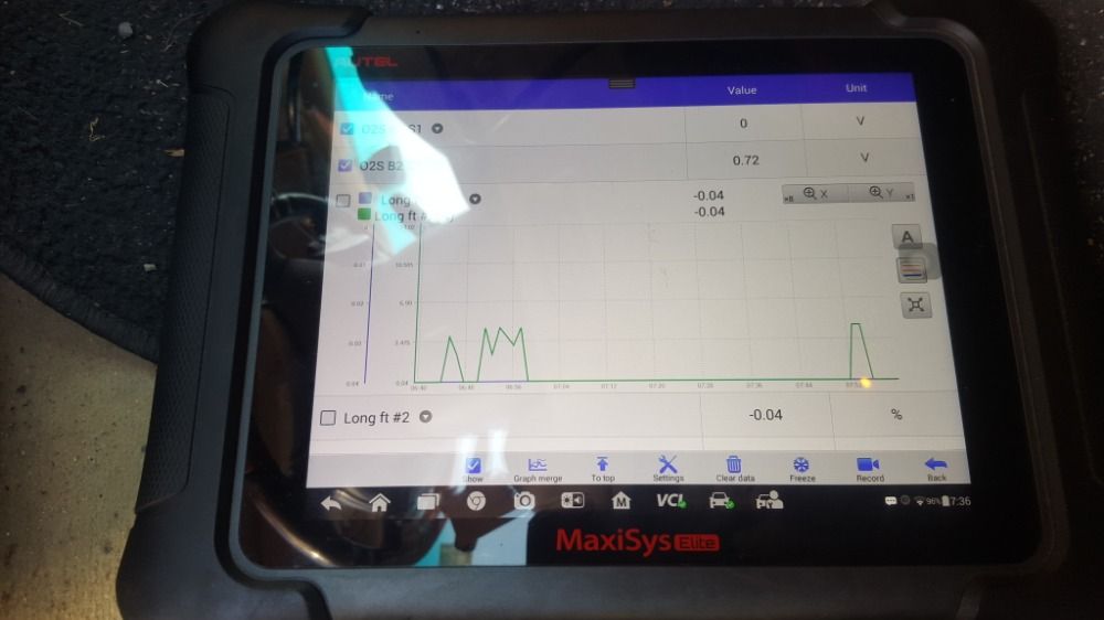

Thanks Andy - I will look at that - it does have new oil though but not sure about the valves(dirt) condition so will pull them off. Since joining this (very useful) forum I am now paying more attention to fuel trims, I was concerned about the fact that bank 1 has no fuel trims. This morning I got it running and noticed that there are no fuel trims for bank 1 and no activity on the oxygen sensor so I will scope that next. Probably nothing to do with the problem at hand but I've also learned to never ignore an obvious fault because "a computer is as clever as the person who programmed it" so weird results do happen.
In my photo it can be seen that bank 1 O2 sensor is always at zero volts and zero fuel trim.

It's been a while but the mechanic got around to doing an oil pressure test at the sensor by the oil filter. Then he did a full oil service and checked pressures again and saw about a 5 psi difference. Next we ran the engine and energized the solenoids one at a time and each time the engine almost stalled.
After clearing codes I ran the engine for a while and my scan tool showed 2 codes and one pending code. I checked freeze frame data and saw ECT was at -40 degrees. I found the ECT plug half off and pushed it in again hoping that this was the cause of the fault, the ECU expecting more movement at a different viscosity. Not to be - within 2 minutes of running the engine the two codes were back along with the pending code P1651 "VSV for ACIS circuit malfunction" - I'm wondering if that is due to a plug by the engine that looks like it used to be on something that is no longer there? The main issue at the moment is that the two codes P1349 and P1354 both return within a minute of idling.
I see a 12% duty cycle pulse at both solenoids at idle - when the wires were cut to energize the solenoids manually the both stopped getting their pulse suggesting that the circuit must be complete if the ECU can sense when it is open circuit.

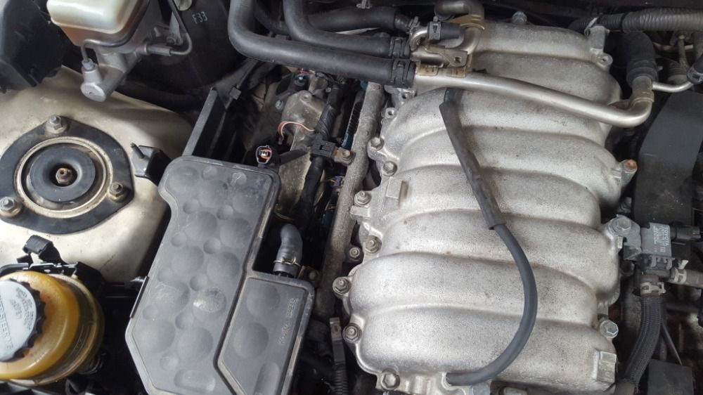

In the middle-left of the picture there is a plug that looks well used - enough for the clip to be broken. there is a taped up air hose on the side of the intake box and then there is a hose going from the top of the manifold to the back of the manifold that doesn't make sense. I imagine this could all be related to something that should be there that isn't.

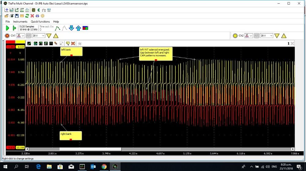

This morning I found the cam sensors, halfway between the injectors on either side. If I scope them both and activate the
one VVT solenoid at 100% duty cycle for a few seconds the engine runs rough and you can see the change in the gap between the two patterns. However I'm not sure the gap is as big as it should be?
