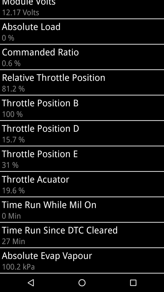

Its running rough like its in limp mode, occasionally sputtering but runs. Heres a snot of some values of freeze frame data with the connector plugged in
This is with my foot off the pedal.. Also, the battery is brand new as the old one ( oldie couldn't hold a charge due to age and usage)

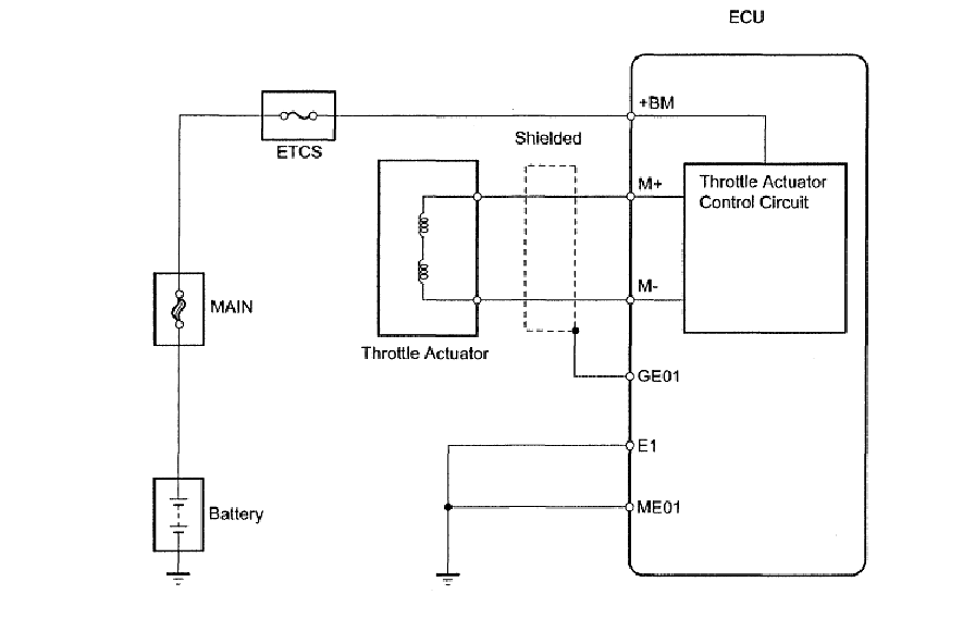

Looking at the circuit I came to a realization I may not have used the test light correctly. Guess i'd need the dtc is set when the computer senses little to no power feed on the +BM wire at the ecm. So I will start there OR a soft reset- meaning to clear the code and see if it comes back?
I remembered also this is drive by wire system and cant be tested the same way as a Throttle with linkage

That's where I was going to suggest going if the soft reset doesn't work - tracing out the ETCS fuse circuit to the PCM and make sure it's good there. Thinking about burned fuse box connections, mostly.
And by soft reset, I meant disconnecting the battery cables from the the battery and shorting them together. Key off, of course. This serves to discharge any keep alive memory and 'reset' any modules bothered by the weak battery. I should probably mention that, if this works, then you'll need to clean the throttle body. This soft reset will also clear the PCM's throttle adaptations, and it won't relearn correctly with a dirty throttle.
