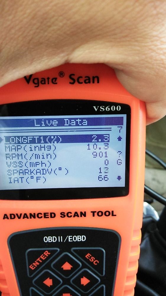

7 years 11 months ago #24787 by Tutti57
What is your long term fuel trim reading at idle?

Ok so here is the fuel trim
