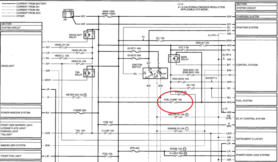

7 years 11 months ago #24949 by Tyler
Replied by Tyler on topic Re:Mazda 6 P1487 and P2227
The fuel pump fuse? :huh: You mean this one?
I think you ended up changing the behavior of the ground side controls when you pulled the fuse because you disabled the Main Relay, and probably some power feeds to the PCM.
TBH, I think you're gonna end up going in circles with this ground bias voltage. :silly: All those other outputs work well enough despite the bias, right? So I'd suggest that the voltage is intentional, or at least unrelated to your EGR codes.
I don't have access to SI right now, but I'd love to know the exact set criteria for the P1487. If it's purely a circuit code, then that's one thing. If it starts talking about EGR performance, then I wonder if hoses (and a clogged EGR valve in the intake) is on the table, too.
The following user(s) said Thank You: Mitchroberson
  • Mitchroberson
  • Mitchroberson's Avatar Topic Author
7 years 11 months ago #24951 by Mitchroberson
Replied by Mitchroberson on topic Re:Mazda 6 P1487 and P2227
OK that is very possible. And i have been thinking about why the other sensors are not kicking a code. However I thought my wireing diagram showed that the fuse was not related to main relay so I will check that out again. I did also notice that the EGR valve is warm to touch, just with KOEO, it cools down when unplugged. But I believe this EGR is energized when KOEO
from what I understand and what the scanner (cheap scanner) says it is a short on either the B+ side or PCM side. So it looks to me like it is some circuit test.
i would think with the PCM Ground side switching that I would just see an open so basically ghost voltage. But with the spikes to 5 Volts on the signal side it bothers me.
One other note is with KOEO we hear a relay about every 10 min. it is not consistent but does seem to switch every 5-15 min. I do not think this is related however.
Car runs great. So probably not going to do much till next week on it.
  • Mitchroberson
7 years 11 months ago #24953 by Mitchroberson
Tyler Looking back at the diagram I have I now see where it does affect the main relay. So very possible this affected other systems. And dropped voltage to a lot of things. Thanks for pointing that out.
Pretty much anything ground side switched by the PCM has the voltage on it. which makes be thing of bias voltages but I thought that was mostly on Positive side switched.
I have confirmed PCM power and grounds are all good. Trying to think through my next steps now.
