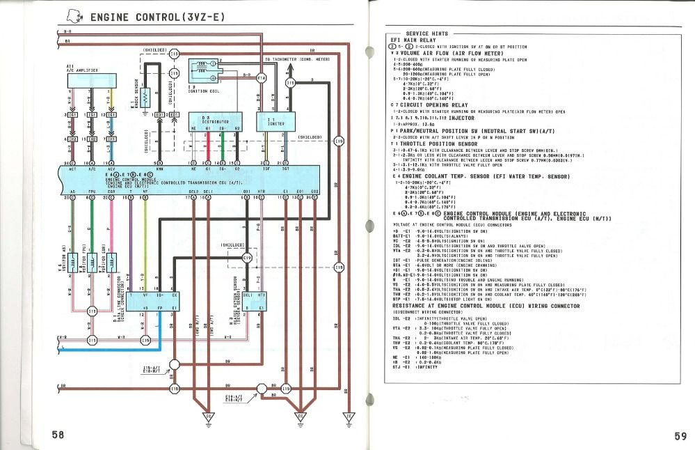

The check engine light gets power from a common fuse ( at the drivers kick panel) to the gauges and its ground side is controlled by the pcm.
First step is to verify the powers and grounds of the pcm. I attached the engine performance wiring diagramms for your engine . Check them all but do it preferably with a sufficient load. That means with a lightbulb or something similar that will draw some 4amps,a testlight might not be enough to stress the circuit.

I think a part of the diagram is missing. I found the 'Malf. Ind. Lamp', with what appears to be power from above and a violet line going down. It splits into two : one going to the datalink connector, and the other going off the page. I don't see where it connects to the ECM.
Also, I don't see where the signals come out of the distributor to the ECM.

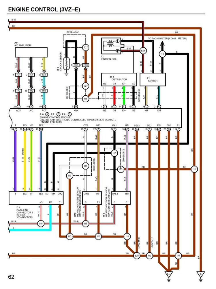

I found this excellent wiring diagram. Now I am trying to relate the numbers on the ECM to the actual pin locations, and in what bundle.

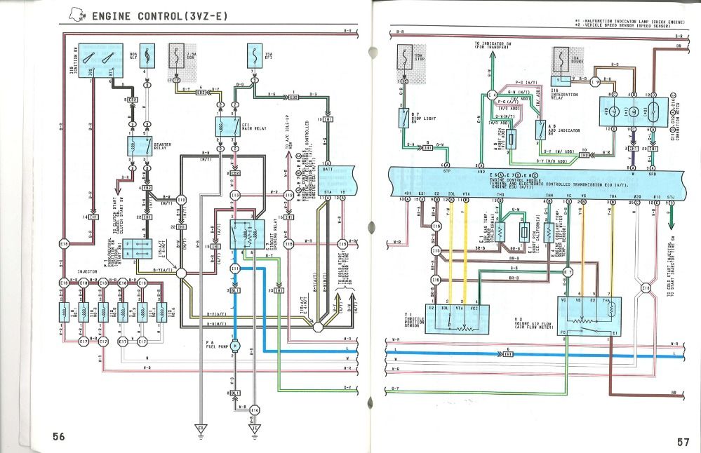

I am plenty baffled. I am attaching what I believe to be the correct wiring diagram for this engine. All of the wire colors and number of wires in connectors (that I could see) are in agreement with this diagram.

7 years 11 months ago - 7 years 11 months ago #25098 by Desmond6004
Replied by Desmond6004 on topic 1995 4runner crank no start
Unplug all the injectors before checking both wires at the plug, just to be sure you're not getting feedback from the others.(just looked at that wiring diagram, they share a common positive but 3 joined together at a time for triggering so there will be feedback of 12v on the trigger wire
of the one you unplugged)
Also: You state that there is no check engine light since the problem started - does it not even come on for a second when ignition is
turned on? This could be one of those rare cases where the ecu has failed. You need to check all your ecu feeds to make sure.

7 years 11 months ago #25099 by Andy.MacFadyen
Replied by Andy.MacFadyen on topic 1995 4runner crank no start
I think the lack of voltage to the distributor is interesting --- I will have look over the wiring diagram
But to clear up the 12v on both pins at the fuel injectors
Engines produced before the mid 1990s usually bank fired the injectors in groups, so when only one injector is disconnected 12v on both pins on a injector plug is normal key on engine off. You need to crank the engine with the test light connected to a test light and watch for the test light blinking.

7 years 11 months ago - 7 years 11 months ago #25100 by Andy.MacFadyen
A search revealed these distributor use two magneto-ressistive variable reluctance sensors --- they generate their electrical signal so no 12v supply is normal.. Toyota used a number of variations of the system What is the wire color and connector shape at the distributor ?
