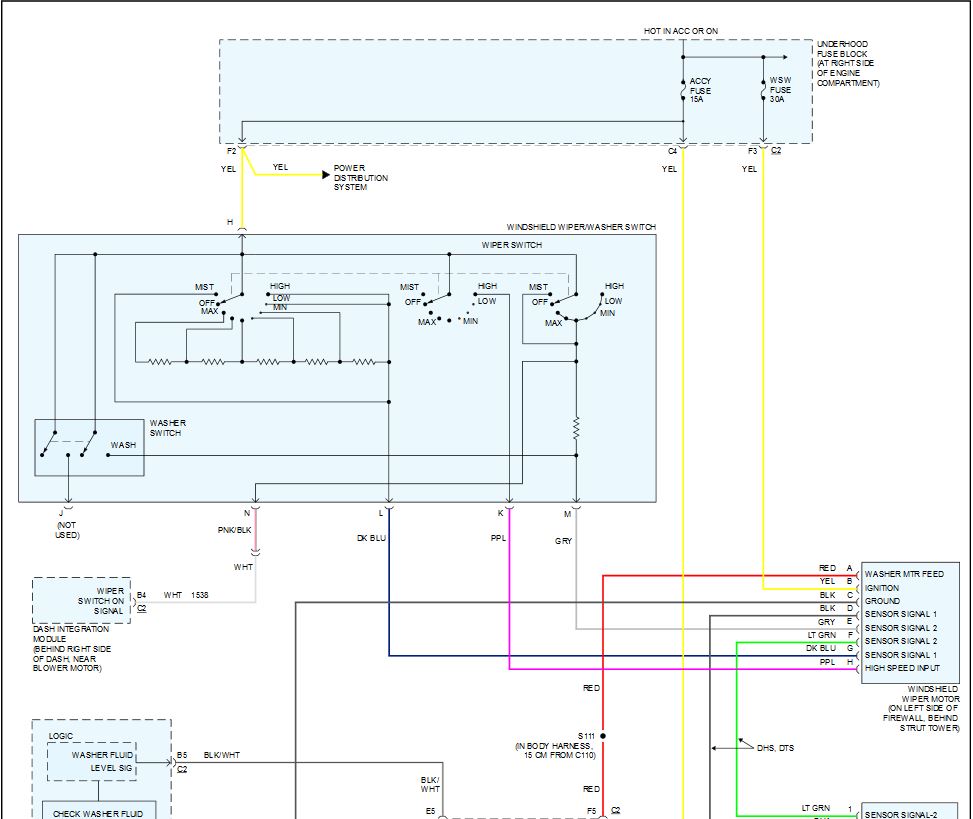

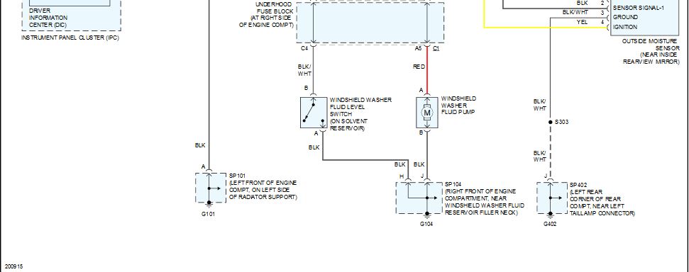

Working on a 2005 Cadillac DeVille. No wiper operation dies anyone have a Mitchell or OEM wiring for this vehicle so I can trouble shoot them and get them back to working
7 years 11 months ago #24959 by Chad
Replied by Chad on topic Wipers on a 2005 deville
