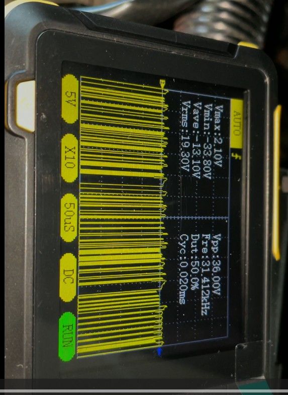

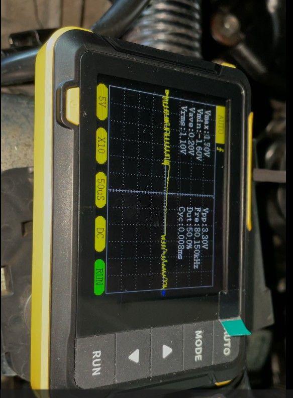

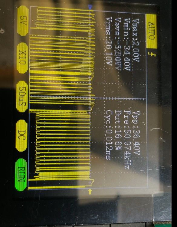

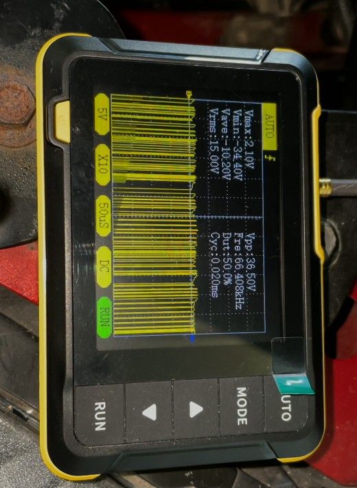

Further to my earlier post I have borrowed a small scope and have measured the HS can at various points. Unfortunatly I am unable to measure the running car at the pcm
The HS can at the pcm on the non running car has lower activity when connected to the pcm. When disconnected the activity increases to a level seen at other parts of the HS can.
The voltage reading may give a clue to what could be wrong.I'm sure this is telling me something however I'm not familiar enough with scopes to interpret the info, can you help?
Whilst there is communication with the pcm and all other modules on the scan tool the rpm signal doesn't reach it. The immobiliser says it's off. There are no DTC'sScope setting were kept the same. pictures added
