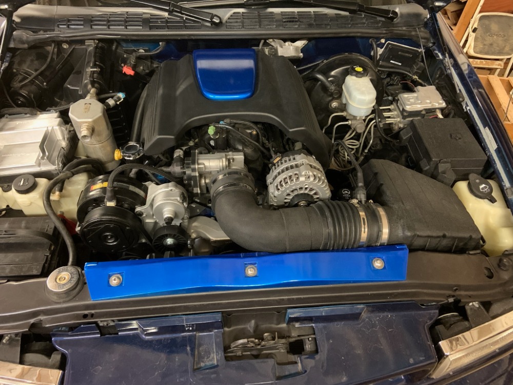

I have a 02 Blazer that I have swaped a 03 Envoy 5.3 LS engine. Truck runs great and all gauges and systems work as they should. Problem is I am have a code set at first star after sitting over night or a 2-3hr sit. I have replaced the wire harness for the tac to Throtel body complete with new connectors. New AC Delco throttel body. New grounds . Any help would be appreciated
