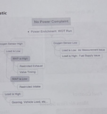

No problem! I'd suggest attempting a WOT run through first and second gears (if it'll get there at all). Watch these PIDs:
-Engine speed
-Loop status
-MAF voltage (or g/s if you're in Global)
-Load %
-Both upstream O2's
-Short and long term trims on both banks
On a good truck, the MAF should get to 4V or darn close at peak engine speed. Load should go above 80%. Both upstream O2's should go over 800mV and stay there while your foot is on the foor.
When not doing the WOT run, observe your trims. High at idle, or high when cruising? Don't worry about what they do when in Open Loop, just Closed.
There's also a handy flow chart that explains the process:
The following user(s) said Thank You: forumoto

7 years 11 months ago #25084 by Tyler
Thanks for the videos! The trims getting much worse off idle definitely suggests a fuel delivery problem.
Any chance you could do another capture with those same PIDs (plus the upstream O2's) at wide open throttle? That'll help clarify which direction to go with our diagnosis.
