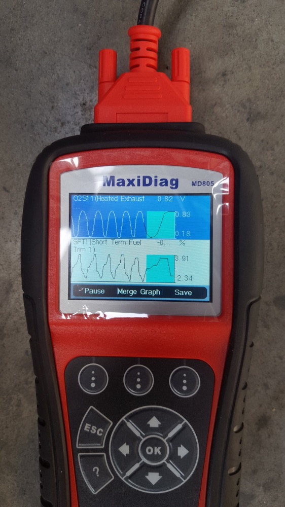

I'f I'm thinking of the correct system your oxygen sensor 1 should be reading as in this image - if it's stuck on 0.8 the fuel trims will keep going negative to bring it down again and eventually throw the fault code.
