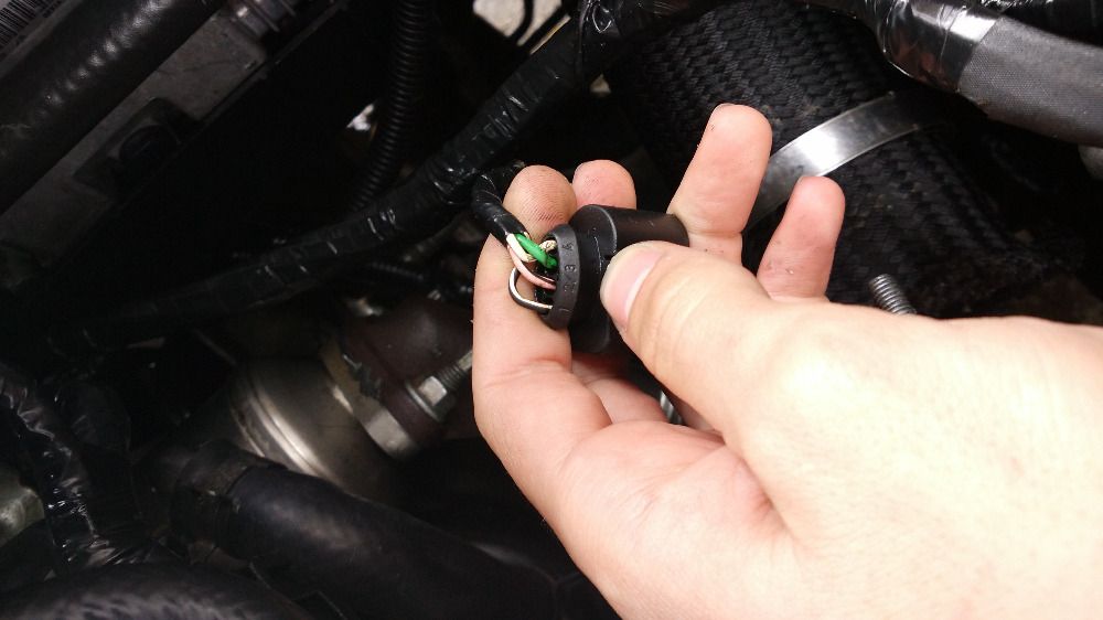

I received the ETC(Electronic Throttle Control) body whole. The mechanic stated that it stays wide open and it seemed to keep wanting to go more open as if the motor inside didn't get any sense of the position it is at. I thought okay TPS faulty...
This ETC is all in one. 4 Pin connector. (see; Throttle Plate Actuator @ bottom image)
1. Ground
2. B+ 12V
3. Control
4. Feedback

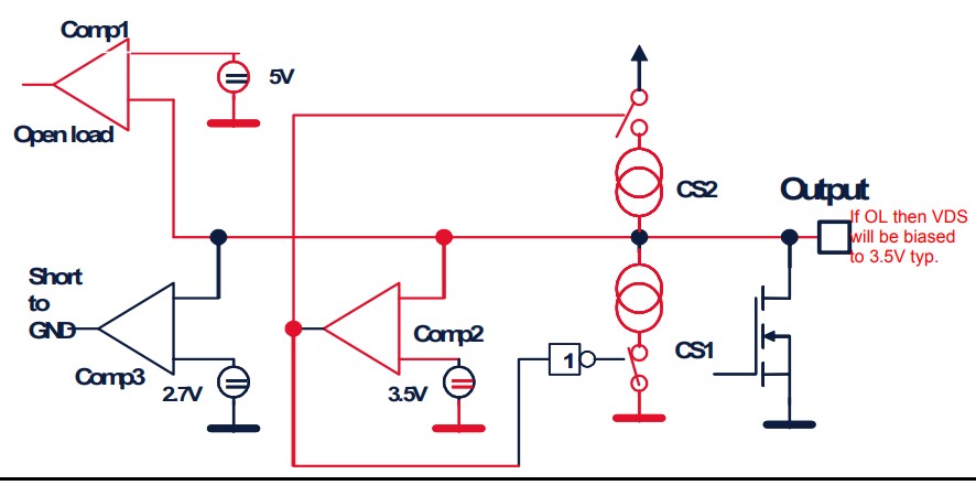

I hooked up my bench PSU and see if I can replicate the issue. And sure I did. Giving it GND, 12V and 5V control pulse 25Khz(I tried 400hz freq didn't respond) 50% duty Cycle; made the motor open the butterfly and wanting to keep opening it past the stop position. (Which is actually part of the case, the gear inside is physically stopped) So again here I thought maybe the TPS is acting up or something. So I opened the module I reworked the PCB and checked the TPS which in this case is hall effect 3 pin. It responded fine when you move the gear like the butterfly would operate normally. (From a low voltage to near 5V). But no feedback.
After the rework/reflow and various testing, I hooked up the bench PSU and the Generated PWM and it actually worked. It responded perfectly. Feedback was also good on the scope. So I gave it back to the mechanic and they tried it.... Only to call me back and say its still doing the same. Sad face...
I went out to the garage and took my scope with along with my pwm generator. I hooked it up and tested the throttle actuator disconnected from the engine and it once again worked fine. I the proceeded to check the control wire on the car since I was there. Only to find 3.5V and no pulse (Ignition ON) & same when engine running.
I found the 3.5V on the Control pin for the Throttle Plate Actuator very odd. I checked the TMAP, Fuel Rail pressure sensor they gave 5V...
So that was weird... Here I found out it has been jump started a lot and it stood for a long period as well. Using the diagram I figured maybe its just a bad wire from the ECU to the plug of the ETC. Here I also found out they checked continuity when they removed the loom.
We then unplugged ECU as it it in engine area. We found some wetness inside the plugs but it seemed more like an oil based liquid. I plugged it back in after cleaning the liquidness and letting the plug dry / air used as well. I rechecked continuity quick and saw it was good.
Once everything was back in I checked pin 3 (control) again on the ETC plug I found 4.4V for a short period and then back to 3.5V. I though uhm I wonder if the ECU got wet. So unplugged everything got it out and on the bench
Once opened I inspected it and it was actually pretty good inside, no sign of anything bad... I proceeded to check the pin to & from the ETC. And found that its one of the Bosch driver chips. I then traced and checked what else runs off that driver chip, I found that the Boost pressure actuator also get's its control from that Bosch Driver. Went back to the car plugged the ECU back in and checked the voltage on the Boost Pressure Actuator and found the same 3.5V which now make me think that maybe that drive chip is faulty. I haven't touched anything else yet because I need to know how the ETC works in this car especially the Control Signals from the ECU
So after the long essay my question. Is the 3.5V normal or suspect? Because I don't have enough experience with this chev to say that its either normal or not. Does anyone here know how its driven? Because I only worked from what I could research on the net regarding these ETC's and how they are controlled and all the info I got worked on 5V PWM.

Okay so after opening the ECU again and tracing some PINS I found that the rest of the Sensors mentioned above do indeed go to another driver, as expected. The driver now in question is the TLE6244x ( TLE6244xDATASHEET )
The datasheet explained fault detection on Short To Ground & Open Load on the channels to give 3.5V which is exactly what we are getting.
So no work done on the ECU closed up for now (will reseal later). I figure we should go through the actuators and components running off the same driver(TLE6244).

To be honest, I have zero experience with the type of throttle actuator you have there. :silly: The US market didn't get the new Captiva until just recently, and we never got the 2.0L diesel. There are no equivalent actuators on US market GM cars that I'm aware of. Kinda pisses me off when I see all the cool stuff other car markets get to play with! :angry: :lol:
BUT, I'm super happy to follow along - this TLE6244 document you linked is AWESOME. :woohoo: Read the whole thing, and some parts several times because I don't speak designer-ese. All kinds of details in there about how this chip talks to the rest of the computer, circuit fault detection, fault coding. This kind of technical information really helps to put SD material in perspective. :cheer:
The open load diagram, for reference:
Check my understanding here? With the channel off, Comparator1 sees less than 5V, so the drain gets biased at 3.5V. That'd infer that the normal voltage on this circuit is higher than 5V, right? Mostly I'm trying to figure out if the 3.5V is a reaction to a perceived open load. If this is a low side driver, then shouldn't there be voltage coming from the throttle to the TLE6244?
Also, back to the Captiva. I don't know this engine, but most of the diesels I'm familiar with have throttles like this for either EGR functionality or runaway control. I'm not sure that a stuck open throttle alone would cause black smoke? :unsure: Sounds like the throttle is a symptom instead of the cause. I'm thinking you're going to find more output issues.

I mentioned Bosch driver in the First post I got that wrong its the TLE6244x it looks like the Bosch Quad drivers...
@Tyler : That's awesome glad you enjoyed it, here is a better one with way more detail regarding that chip it also has a little image near the top. You should have seen this chip by now if you opened ECU's before. Bosch like them. Altho the Bosch ones are usually just a number like 30xxx this one is from Infineon. Feel free to ask more about these chip level stuff. It's what I do. I do have some Bosch me7.1/7.5 Schematics of the whole ECU PCB. It's old but it will give you a really good idea on how they work.
To answer your question regarding your understand on the OPEN LOAD Detection. I don't know :P either some input pin or the output pin is monitored by the chip. The other datasheet contains a lot more info so I still need to go through it to understand how exactly it works and then use that info and put it into perspective with the issues/info I get from the CAR... Fun fun fun Also to mention this chip has multiple functions it's made for Low Side Switching but can also do really good PWM
(Direct Parallel Control of 16 channels for PWM Applications)
As far as I understand it there should be a signal going to the Throttle Actuator on pin 3. and nothing from it. They have a FEEDBACK pin that gives feedback. When I tested this Actuator on the bench I supplied GND, 12V, 5V @ 25Khz 50% duty cycle PWM, and on the feedback I got between 0.6V and 1.3V depending on the butterfly position. So when you close it the voltage goes down and opening takes it up. (Or the other way around, I can't remember too many things to keep in mind :D)
When I opened the Throttle Actuator/Body. They have a PIC18F inside doing the controlling of the Stepper Motor and the TPS signal. They step the voltage down from 12V to 5V inside as well. They have a H-bridge setup inside to drive the motor. Which again tells me that the Control signal is merely just a signal... But the thickness of the control wire makes me wonder a bit. (See Image attached)
So as far as the Throttle Body/ETC/Actuator goes I think it's fine. Even with it disconnected we still get 3.5V on the control line. But yeah open load could mean unplugged... Confusion overload pretty much.

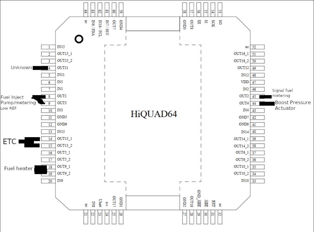

Okay after some tracing I found the following.
See Image Attached.
PINS ON THE LEFT IS ECU CONNECTOR PINS ON THE RIGHT ARE CHIP PIN OUT.
ETC Pin 59(J2) = Pins 14&15 OUT13_1 & _2
Boost Pressure Actuator Pin 15(J2) = Pin 44 OUT4
Pin 91 Unknown = Pin 4 OUT11
Fuel Injection Pump (metering unit) Pin 49(J2) = Pins 8 & 9 OUT1_3 Both Seems to be for the LOW REF. (Physically connected on PCB)
Fuel Heater Relay Pin 68(J1) = Pins 18 & 19 LOW SIDE SWITCHED
UPDATED:
Cooling Fan Relay(LOW SIDE) Pin 90(J1) = Pins 38&39 OUT14_1&2
Aux Fan(LOW SIDE) Pin 69(J1) = Pins 34&35 OUT10_1_2
AC COMP LOW SIDE Pin 29(J1) = Pins 36&37 OUT6_1_2
Will Try and edit this if I find more.

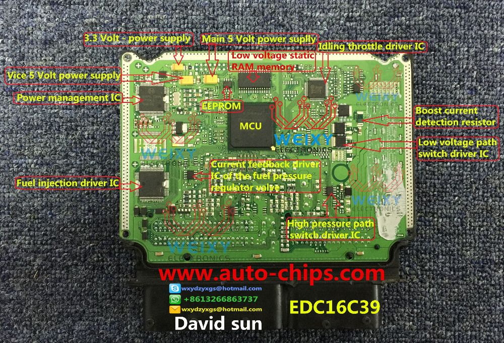

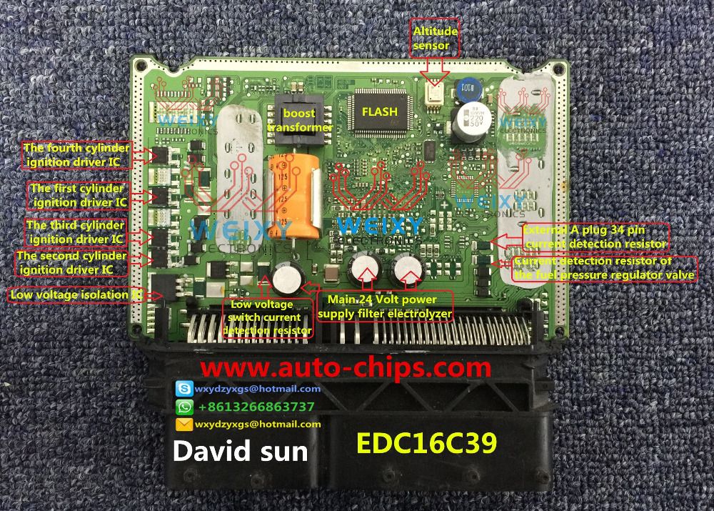

While I was there I had the ECU plugged in and open. I checked the Circuit. The Pin for the ETC Control seems like its a 12V PWM it goes up to near 12V when the ignition is turned on and then goes down to 0V then after a short time it goes to 3.5V. (The near 12V is when its opening and then stop. When the ignition is turned on it does that no idea if that is normal?)
Nothing gets hot the CPU and Power supply chip gets warm as expected.
PSU part on the PCB:
12V input OK
GND input OK
5V Supply OK
3.3V Supply OK
I don't think its the ECU in this case. It kinda seems to respond and do what its supposed to do. Unless there is some IC that's acting up.
While I had the ECU I did rework the IC pins. for both the TLE6244x and what seems to be some other controller. (I found this EDC16C39image
And they marked most of the IC's I don't agree about the TLE on that page because who ever did that labeled it as the Fuel Injection Driver (alone?) which I found to not be the case. Unless that is a bit of an either older or newer model/version PCB(ECU)...
Anyways the car starts a little easier now, but I can't say that its a definite "change" Idle is still rough and it would stall after a few seconds to maybe a minute of idling. Uhm sometimes while trying to start it would knock insanely hard(well knocking is the only thing I can compare it to, I'm no pro with Diesels, I know they are roughish)
Will report back with more info when I get some...

Some interesting links to Bosch Systems and Infineon, most contain datasheets with good info just for some researching and good reads.
Bosch Engine Management System
Infineon Engine Management Details
Like this from Infineon They are pretty much upgrades from the older components...
The ME7.1 & 7.5 ECU its fairly common and the images and docs are freely available online.
autodtc.net/docu/ME71.ZIP
autodtc.net/docu/ME75.ZIP
Those contain pdf's schematics, excel spreadsheets about pin data and some images that point out the chip over functions. Very Very good info, it gives you a really good idea of how the things are setup, like the flow of the board.
