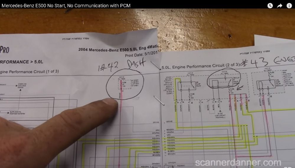

Hi,
My Vehicle is a 2003 E500 Mercedes.
I stumbled across one of Dan's videos (Subject Line) while attempting to correct a no start, with high fan speed condition. I really like your approach Dan, and thought you might be able and willing to give me some guidance.
My condition is similar to your video situation, but in my case, there is no voltage on the Red/Blue Wire, where in your video you experienced no voltage on the Red/Violet. I jumpered the two as did you, but that blew the 7.5A Fuse (#42) in the left-side dash panel. That could make sense simply due to that Red/Blue circuit (larger wire) needing more current than that fuse would allow. Still It makes me nervous, and I don't want to cause further damage.

After watching your excellent video, I had additional hope and methodology, but as I said I've blown fuse 42 and it scared me. With quick touches of power from the other wire, I could hear clicking of a relay towards the center of the motor (Throttle Body?). Looking at a screen shot of your video (attached) though blury, I am able to somewhat discern what circuits we are concerned about. I have no voltage on either side of fuse 43 (15A Engine compartment). That leads me to question the relay (#7 on the diagram), but I am not certain which relay it is per the fuse box diagram (probably I or K). I have also checked the Pre-Fuse box under the carpet on the passenger side Front. The access was so damn impossible such that I have since only peeked at the Rear Pre-Fuse Box in the trunk because it looks to have similar access difficulties. It would make sense to check there, but my confidence and energy have waned, and I see no reference on the diagram to the rear box related to the Red/Blue circuit.
So I am hopeful that you can still dig out the schematic, and I guess my primary questions are:
1) Where does the power (5V or 12V ?) originate to energize the uncertain relay, and Fuse #43? I can't see the diagram well enough to decipher the source of the wires to the relay, though one lead says Left Front Footwell (What does W15/2 mean)?
You mentioned a Power Distribution schematic?
2) And where do the other 2 wires for that relay come from, (ckt #1 and #14 I think, hard to read)? Are they grounds?
3) Were does the Hot At All Times power come from? A Buss in the fuse box I'm guessing.
4) What causes Relay R7 to energize? The turn of the key? In other words, would fuse #43 only have power with the key on?
5) Is that circuit to fuse #43 to have 5 volts, or 12 vdc?
6) How did you decide that those two red wires were "power" for the computer? Just because they were red? There are no +5 or +12 symbols on the schematic.
7) What would you do next?

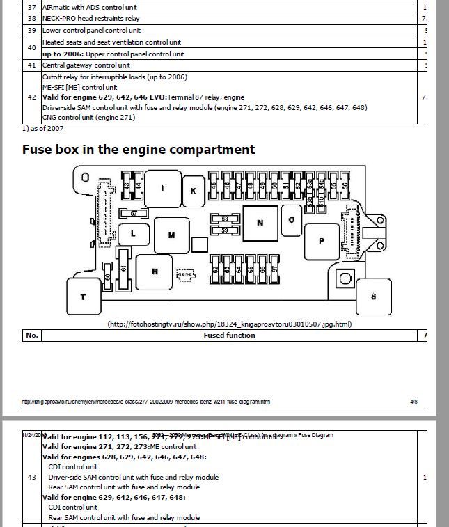

7 years 10 months ago #25333
by BobbyM
Replied by BobbyM on topic Your Video - Mercedes-Benz E500 No Start,(No Communication with PCM)

Replied by Curticat on topic Your Video - Mercedes-Benz E500 No Start,(No Communication with PCM)
Thank you, that gives me somewhere to check. Of course it would be the one zone I figured could have no bearing on the front fuse box, but hey I guess it makes sense, with the battery origination being in the trunk.
Would have checked there by now, but weather has been vile in Kansas City. Tomorrow is to be sunny and warmer, I'll get to it.
And those schematics are from being a member of a particular repair website? Saw it somewhere, but lost track of it. Appreciate the excerpts.
