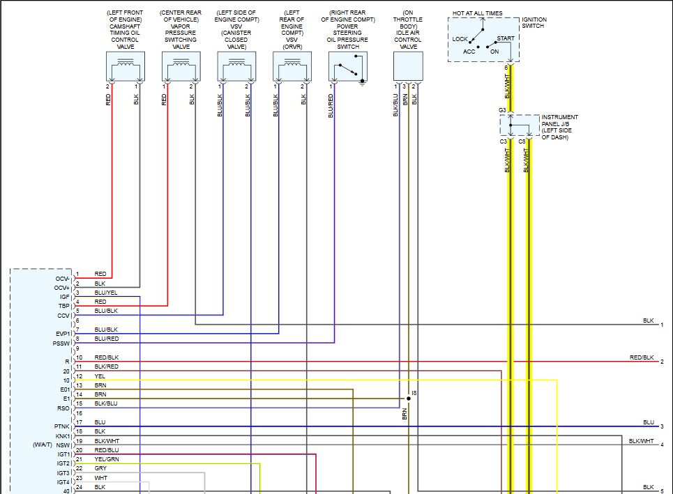

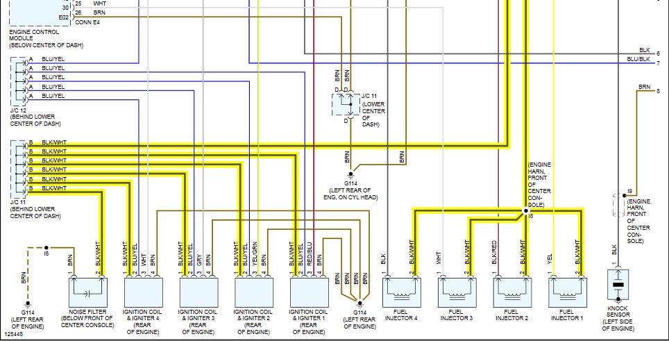

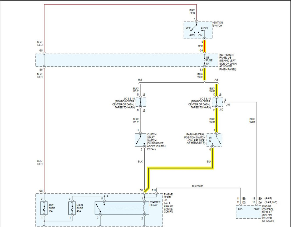

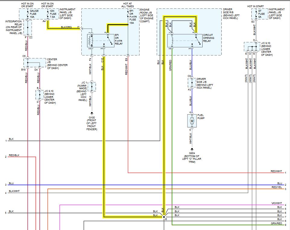

Hello Friends,
I heard a switch on the passenger side turn off my fuel pump. Fuel gauge, was leaking from a loose hose connector, while cranking I now know why the car has not been able to start. I can't find it; the dealer can't find it nor my manuel wire diagram can't find it either (haynes)
The sensors are pulled down by this switch ( fuel shut off) because the injectors, on plug coils fuel pump all have power at low voltages.
The computer power n grounds good and the 5 volt reference is pulled down reading voltages low.
ignition switch does not stat the crank.
starter works when jumped.
The control side of starter relay fuse box does not light test light, when key is turned
The load side of stater relay is always hot with good 12 volts.
I believe the fuel shut off switch was the main cause that pulls the circuits down to low voltage.
I have looked under dash passenger side near air bad devise could not see it. Looked on the right panel and fender sider could not see it.
If i reset this switch i believe the car will start its been sitting for 3 months?

I have the same vehicle I do not believe there is a fuel cutoff switch there isa relay for the fuel pump your pump probably draws about 7-8 amps I am not sure what the issue is are there any codes

if starter works when jumped I would check battery out it sounds sulfated

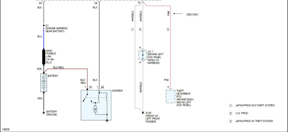

It sounds to me like you may have a theft deterrent system fault. Can't remember off the top of my head how Toyota system is but it sounds exactly like common security fault on the older GM vehicles. Do you have a security light on or flashing ?
