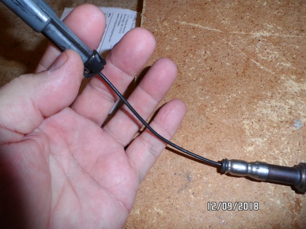

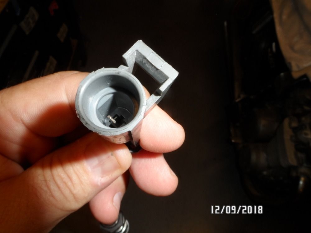

the o2 sensors are new and they dont have heaters?,,, thanks
7 years 10 months ago #25290 by Tyler
Retired wrote: the o2 sensors are new and they dont have heaters?,,, thanks
The downstream sensor isn't heated? The wiring diagram says it should be, anyway. :silly: Not trying to tell you how it is! Just genuinely confused.
  • Retired
  • Retired's Avatar Topic Author
7 years 10 months ago - 7 years 10 months ago #25292 by Retired
just a single wire to o2 sensors? replaced with a bosch # 13022. single wire plug, heat and ground come from exhaust pipe
