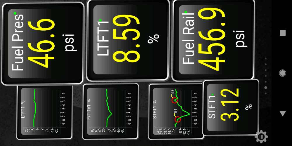

7 years 10 months ago #25676 by SixOneFour
Fuel pressure at idle seems to be sitting around 43 to 45 at idle, fuel rail 420 to 455 at idle, when I rev up to 2500 to 3000 rpm the fuel rail only seems to reach a steady 8 to 900ish but if I give it one quick rev it goes up to 1700+

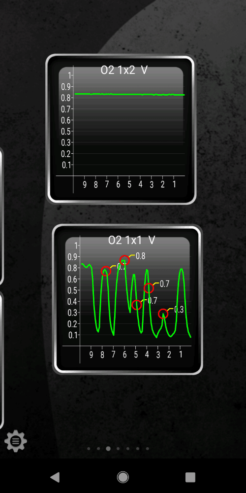

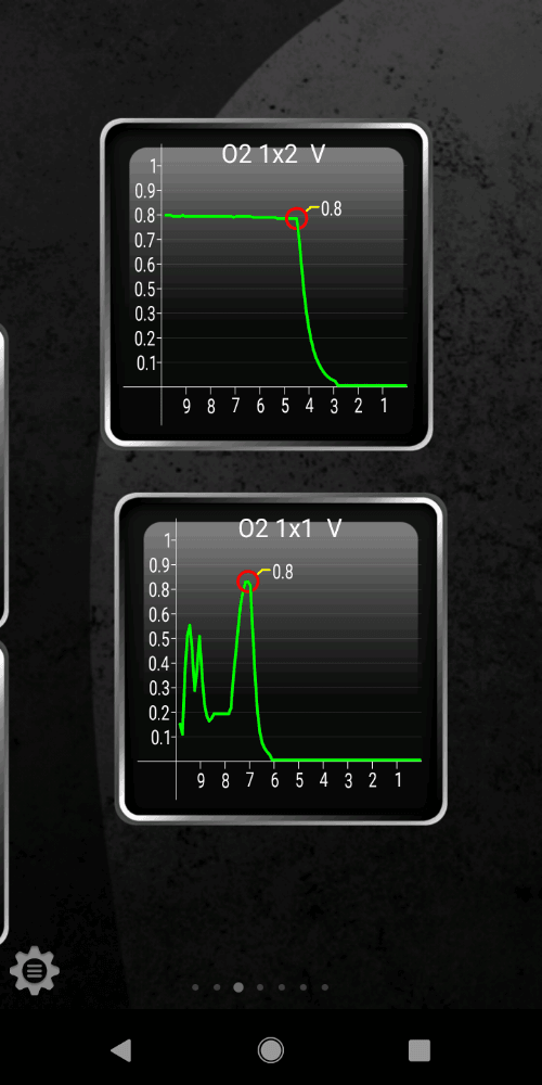

  • SixOneFour
  • SixOneFour's Avatar Topic Author
7 years 10 months ago #25982 by SixOneFour
Here's a few screen shots at WOT if I did this correctly. I'm still a noob on this forum. Upstream and Downstream o2 sensors, I noticed the downstream taking a dive in voltage when letting off the accelerator from WOT coming to a slow or stop, then it will go back up to around 0.8ish and stay. Keeps doing that. I have a new downstream sensor but have yet to replace it, the upstream is brand new. All parts I use are OE
