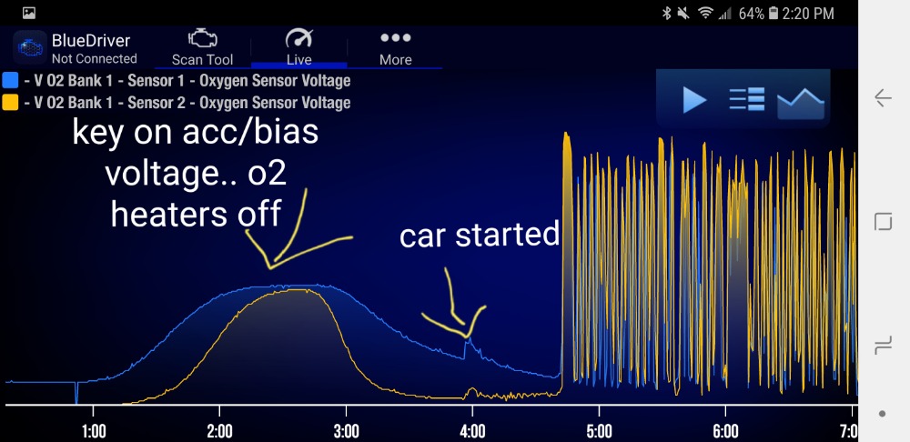

About once a week or so i have to clear the check engine light for this cat inefficient code, ive heard a bad cat can cause this or a o2 heater can too but my question is when i turn the key to run the millivolts immediately start dropping down from the 450 volt bias but sensor 1 and sensor 2 are like. Mirror image of each other instead of sensor 2 being steady rich

I would go straight for a bad cat on this, the downstream O2 showing an exact echo of a normal upstreamO2 hi-lo-hi-lo-hi-lo pattern when the engine is up to running temperature is the classic symptom.

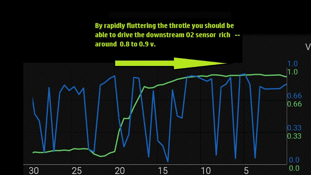

7 years 10 months ago - 7 years 10 months ago #25528
Replied by Andy.MacFadyen on topic P0420 bad cat?

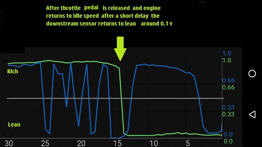

The downstream is exactly following the upstream roller coaster --the upstream fueling is closed loop and giving the cat the ideal working conditions - as long as the coolant is fully up to temperature, raise the RPM to 3,000 or so for a minute or so than allow it to return to idle if the downstream returns to the same roller coaster pattern crossing the 0.5v mark every 1 or 2 seconds or faster the cat is dead ..... no point on testing further
