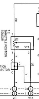

7 years 10 months ago #25546 by Tyler
Hey andrameda! Lemme grab the diagram for reference:
File Attachment:
File Name: corolladiagram.pdf
File Size:638 KB
Would you mind clarifying your readings at the TPS for me? Here's the sensor:
Brown is sensor ground, yellow is the 5V reference, and light green is the signal. Please let me know what the voltage reading is on all three wires, KOEO, plugged in and unplugged. :cheer: Obviously, having 12V on any of those is a problem, but we need to be clear about which one is too high.

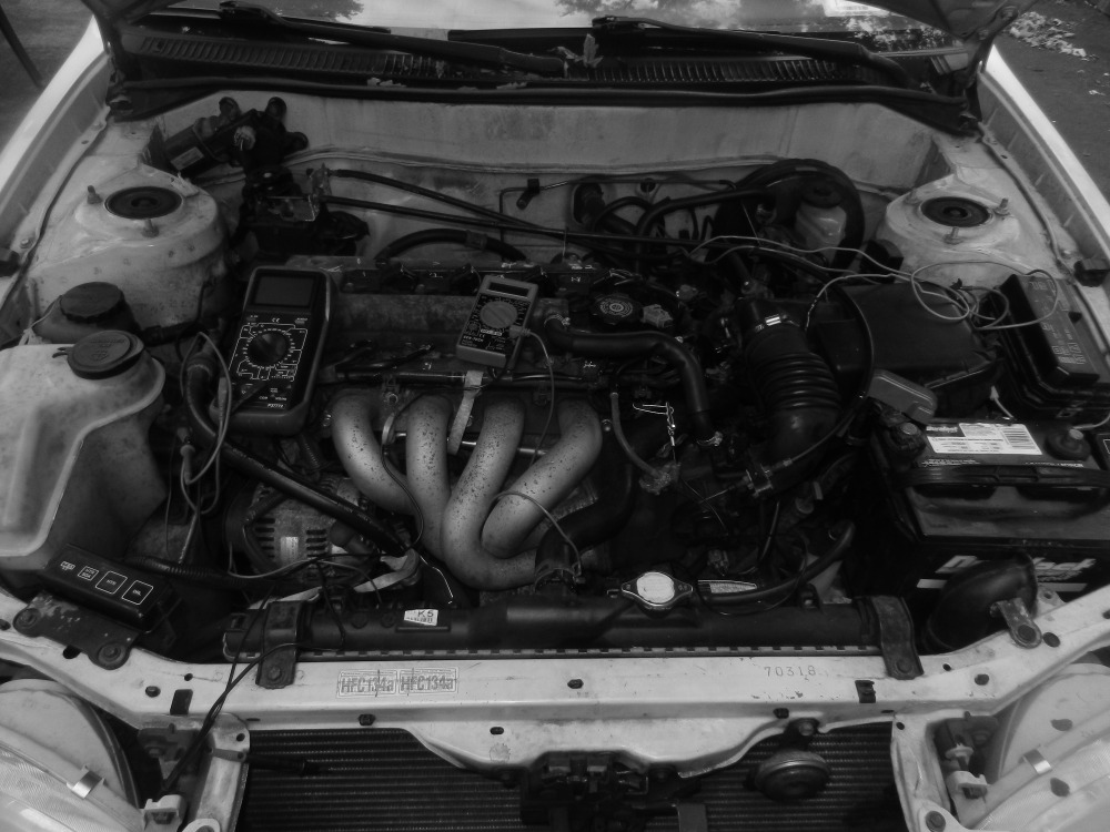

7 years 10 months ago #25653 by Tyler
Alex, are you sure you're testing the TPS, and not the IAC motor? :huh: Because the readings you're seeing make WAY more sense when considering IAC operation.
The IAC on your Corolla gets a 12V feed on the middle wire, a constant ground on another, and a PWM ground from the PCM on the last one. That matches the readings you took. The wire colors don't match, but they didn't match the TPS, either. :silly: If I'm right, then the 1.67V reading you saw would suggest that the PCM is alive and operating the IAC.
To be clear - unless the wiring on your Corolla differs significantly (besides wire colors) from the US model that I can find diagrams for, there is no direct connection between the fuel pump and any of the sensors we're testing.
Maybe try taking measurements at the ECT instead? KOEO, sensor disconnected, measure both pins for voltage. One should read 5V, the other should read zero.

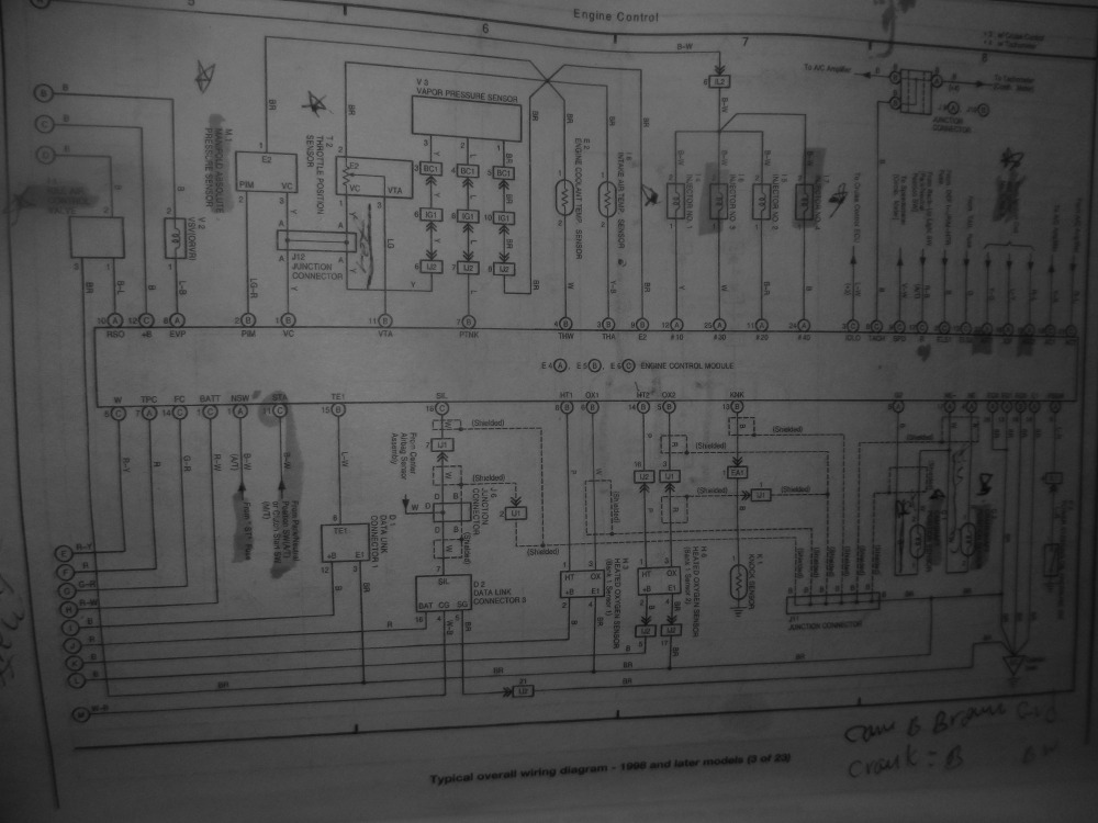

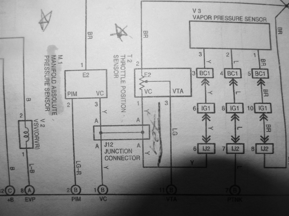

7 years 10 months ago #25813 by Tyler
andrameda271 wrote: what you call the brn wire as grd is light green reading 0.01 volts on the throttle sensor ; the air control sensor is on the opposite side of the throttle sensor which had the steel cable from accelerator pedal.
OK cool, thanks for clarifying! :cheer: No insult meant! Just making sure we're on the same page.
What you call yellow wire as the 5v ref on your diagram ; is a black with green trace middle wire which is reading a 12.36 voltage.
the blue with blacj tracer reads 1.67v it seems to be the ground on my wire diagram from haynes corolla repair manuel.
Silly Toyota, why make the wire colors different? :angry: :lol: Is there any way you could take a photo of the Haynes diagram and post it here? That's help me tremendously.
So it is interesting that it is in the reverse order should I risk jumping the 12v wire to ground without a resistor?
I have a 4.7 ohms resistor should I risk jumping the 12 volt wire to the 5v ref wire which reads 1.67?
Negative, let's not jump anything until we know what's what. Mostly, I'm worried that if you add a ground to either circuit, you'll be providing a ground path for other high current devices that are also looking for a ground, and end up cooking something.
Do me a favor and check the ECT as I described above? If you see the same 12V or the 1.67V reading that you saw on the TPS, we're onto something.

7 years 10 months ago #25857 by andrameda271
enclosed are pictures of Haynes wire diagram fuel pump n open relay for fuel and the throttle colors wires; engine bay showing throttle cable and below that the gray color connector to throttle sensor behind the throttle is the intake air temp sensor.
in this car the colors of wires are different. light green is ground 0.01v; dark middle wire with green trace reads 12. 36v; blue/ black wire reads 1.67v, which according to your sensibilities is the ref 5.
To be or not to be: do be do be doo!
