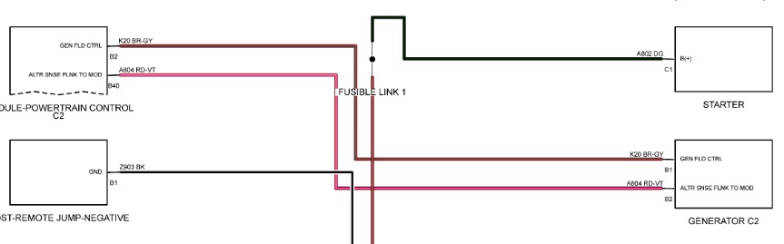

working on a 2012 200 4 cylinder customer complaint he said the battery light was on. brings it to me and no battery light no dtc's except for some in the abs module for high battery voltage. I check the battery wire from the battery it has power. checked the generator field control wire its pulsing it on and off. voltage dropped the negative side got 32 mv. reading live data in the pcm sensed voltage is 14.43. but when measuring it with a meter at the alternator im getting 11 volts. didn't find much information on what this is supposed to read.

So, I was kinda confused with the 'sense wire' you were talking about... I always found that these two wire Chrysler alternators just controlled the field strength, and didn't 'sense' anything! But, sure enough, the diagram says there's a sense wire:
My bad! :blush:
Have you gone on iATN for this yet? I found a post by Louie Bernstein that is worth reading, if you haven't already:
members.iatn.net/forums/read/msg.aspx?f=...m=379757&fv=3&page=1
What is the modified "A"? One field will be INTERNALLY connected to B-Plus, and the voltage is controlled by PWM to ground of the other field lead. So, then on the modified "A", how are the 2 pins configured? One pin connects to the field lead, so if you ground it the unit will full field. The other lead, on what I dealt with today, is "voltage sense", and it internally connects to the rectifier, or B-Plus, but through a high value resistance, and then to the PCM. What does this mean? When it is charging normally, or if you force it to charge by full fielding it, the voltage on that "sense" line will be LESS than the alternator output voltage. This is normal, and it is how the system is designed.
On the newer Chrysler "B" systems (field internally grounded), it is field energized by feeding a PWM B-Plus to the field pin, and can be tested by doing a direct battery connection to this field pin, as long as you are sure of what you are working on. The sense, again, is not a direct connection to its output, and therefore the voltage on the sense line will be LESS than the alternator output voltage.
This makes it sound like your 11V reading is OK :blink:

Yeah, it's definitely confusing, Andy. I had a chance to look at the description/operation on this alternator, and this is what I got out of it:
The 'sense' wire is connected to the alternator output across a resistor (dunno the value), which goes to the PCM. In the event that the alternator output cable comes loose, or there's an open in the alternator output circuit, then that sense voltage will read higher than normal, and the PCM will shut the alternator field control off. A safety circuit, more than anything. The resistor explains the low sense voltage.
The service info didn't say this explicitly, but it's my interpretation that the charge rate isn't determined by this sense circuit, but by other inputs. This would explain why the voltage PID never agrees with with sense circuit.
I'm paraphrasing, but that was my take away. I can expand on this tonight.

known good 2012 dodge charger thought it was a 2013 yesterday... measured 14.27 volts at the battery posts. checked the sense wire at the alternator reads 10.8 volts. also didn't think to read what the verus had on in it in the guided component test it says b sense reads 3.5 volts less than the charge voltage so that's what I had with the known good.
