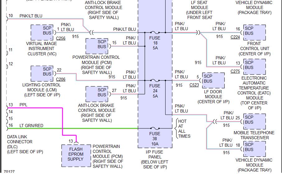

Hello everyone, this is my 1st introduction to the forum. Ill go ahead and start with the nitty gritty. 1995 Lincoln Continental 4.6. Crank no start condition. Has no spark or fuel injector pulse. No power to fuel pump. Its obd2 however the pcm will not communicate with the scan tool. Scan tool communicates with all other modules. Other modules do have codes relating to missing rpm signal, missing coolant temp, missing vehicle speed sensor input, etc. Tps sensor is getting 5v reference voltage from pcm. Is it possible for the pcm to have good power and ground and even send out a good 5v reference but will not compute or communicate the information it has to allow the engine to run. What does everyone think? Next diagnostic process? Or is time to just order a PCM.

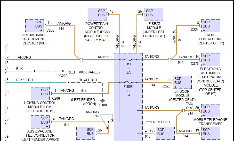

- Posts: 2223
7 years 10 months ago #25577
Replied by Chad on topic 1995 Lincoln Continental No PCM communication.
- joshwilliams010
- Posts: 3
7 years 10 months ago #25582
by joshwilliams010
Replied by joshwilliams010 on topic 1995 Lincoln Continental No PCM communication.
Thanks for the diagram, I did find that on Mitchell prodemand today and all those fuses had continuity, however only 2 had 12v going through them, the others had 5v going through them which I thought was a little weird.
