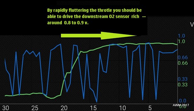

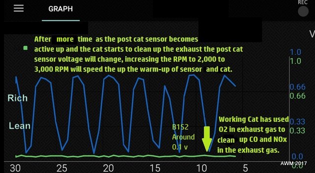

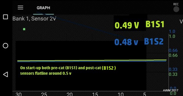

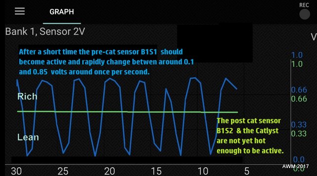

P0420 is flagged up when the engine computer compares the downstream sensor for each bank with the upstream sensor shortly after the engine reaches running temperature. When up to temperature at idle a conventional narrow band upstream sensor should a constant hi-lo-hi-lo-hil-lo roller coaster pattern between 0.9v (rich) and 0.1v (lean) about once per second.
The engine computer will flag up a P0420 if it either detects a lack of changes from the the downstream sensor or it detects the downstream sensor is following the upstream sensors hi-lo-hi-lo-hi-lo pattern too closely.
To start with you should seal the exhaust leak before the cat.
So the next thing is to check is if the upstream sensor B1S1 & B2S1 are following this patterrn.

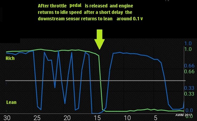

There are number of ways you can drive the upstream rich I usually do it by either introducing propane to the intake or simply fluttering the throttle .

Andy.MacFadyen wrote: There are number of ways you can drive the upstream rich I usually do it by either introducing propane to the intake or simply fluttering the throttle .[/attachment]
Very helpful description and images, thank you :) - was that meant to read "drive the DOWNstream rich"?

The rear O2 sensor 'settles down' because the catalytic converter is 'cleaning' up the exhaust gas by causing the gas to oxidize into co2 and h20.
The catalytic converter in the simplest terms is like an oven containing metals which promote reactions to occur. So if is working at idle, the rear O2 should show that it is working, by the rear/downstream O2 sensor indicating appropriate exhaust gas reactions are occurring, leveling out as compared to the front/upstream O2.
There are certain driving situations when the CAT cannot work quick enough, like quick snaps and the like. This would make the downstream O2 look more like the upstream O2.
