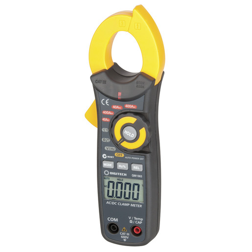

I use a dc clamp meter for this kind of problem.
As you say you have already removed the fuses and relays the next step is to trace the direction of the current draw.
Could you have possibly missed a fuse box?
Something we see quite often here is a hidden gps or old alarm system has been fitted to a vehicle unknown to the new buyer -
depending on whether you got it new or not? I'd be looking at the ignition key wiring next because that is usually where people
connect things like that.
With a clamp meter you can put it around the cables leading from the battery and follow the wires with the current draw in them.
This isn't always easy because sometimes it's hard to get to the harness but has helped me many times.

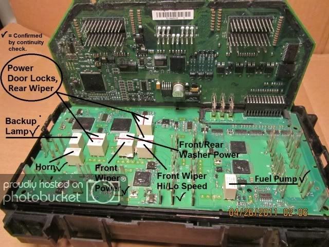

Open your fuel cap and listen....
That range of Jeep/Chrysler vehicles have a hidden fuel pump relay buried inside their TIPM (Totally Integrated Power Module). The relay fails, and many times it fails in the stuck 'on' position.
There is an external relay kit you can install on the vehicle that eliminates the internal one so you don't have to buy the $1200 TIPM and then have it flashed.
You install the kit and no programming is required.
This may not be your problem, but I've seen it more than once now and I'm not working at a Jeep dealership. It's worth a quick check.

It's integrated into the circuits inside the module. Soldered to the board. You can't get to the relay.
But, if it's staying on, you should be able to hear the fuel pump running when you open the fuel cap and listen. If that is the case, there are Youtube videos out there that show the work-around kit and it's install.
That's not the only relay they integrated inside, but it's the most common to fail.

Here's a visual from this very enlightening thread.
www.jkowners.com/forum/stock-jk-tech-dep...-oem-tipm-study.html

A fuel pump, even pulse width controlled, will draw considerably more than 1.8 amps.....

Good point, most fuel pumps will pull at least 3-5 amps when running. I hadn't paid attention to his readings.
Also, upon rereading the original post, I see another problem in my theory. It says that all fuses were removed and the draw still existed. The TIPM has the fuel pump fuse, which if you read the wiring diagram the fuse is AFTER the relay. So, if the draw still existed with all fuses removed, it cannot have been the fuel pump relay.
That might be the answer to solving the riddle, though. Since we know there are several more relays buried inside the TIPM, I'd check the wiring diagram and look for circuits where the relay is shown in the TIPM but not found on its surface. Then find ways to isolate those circuits for testing.
