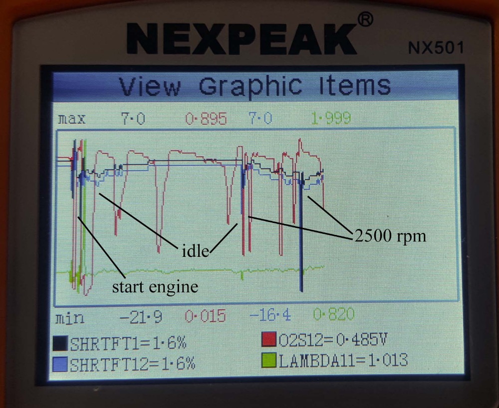

I plugged in the nexpeak to my 2006 Honda Stream today (D17A engine) when we went for a drive, I'm trying to understand more about fuel trims.
I'm just wondering why there are fuel trims for sensor 2 on bank 1? Sensor 2 was quite active and there are no fault codes so it must be right?

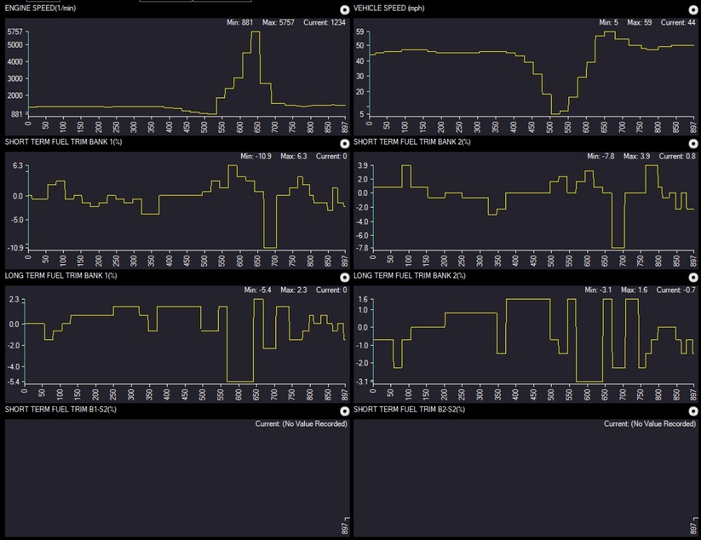

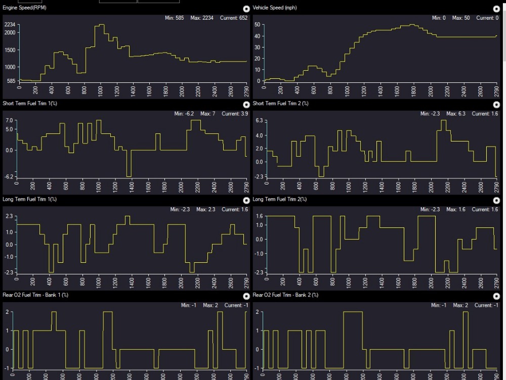

Anyway, yeah those PIDs are tricky. As Juergen noted, it (can) get more complicated in some cases. I took this shot during a test drive of a '11 Ford F-150 3.5L:
Clearly, a downstream fuel control system is in use. Now, same truck, on the Global side:
Nothing. :lol: Just going off this, you'd think there's no downstream fuel control.
