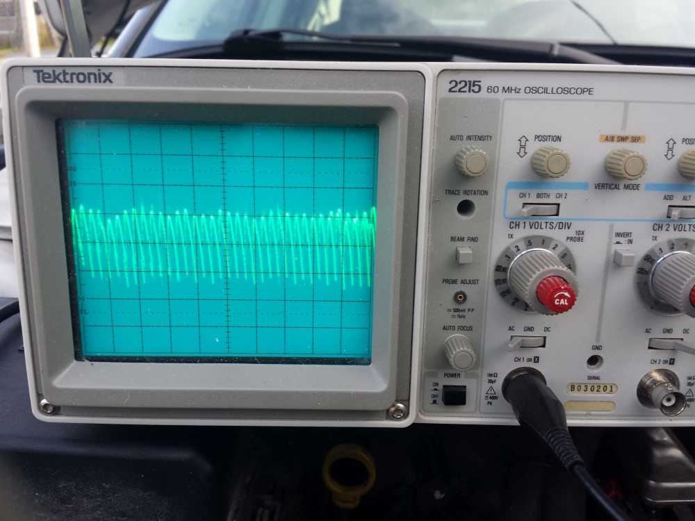

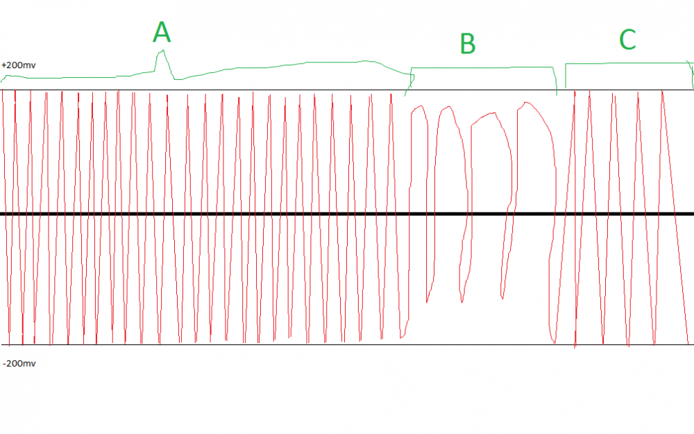

Onto my main question. I was looking at alternator ripple on an old analog 60 MHz oscilloscope and the waveform I saw was very weird. I tried to take a picture with my phone but because the oscilloscope is an old CRT type I could not get a clear picture. I had 400mv peak to peak ripple at idle which seems a bit high but I cannot say for sure that it is definitely causing a problem or not. I dont have any issues starting the car so the alternator in its current state is charging the battery.
The waveform itself was also very peculiar in that it did not look like a series of nice humps in some example waveforms I have seem but rather very spiky with some humps like I would expect sprinkled in. I did disconnect the alternator field winding connector and drove the car, It did run very well and the issues seemed to disappear but I have been fooled before. I really dont want to throw more parts at the car without some evidence. My theory is that since the computer uses system voltage in its base fuel calculations the amount of fuel being delivered is always changing making the car run rough
Using the very best graphics design program to date (Microsoft Paint) I have drawn to the best of my ability what I saw on the scope. The section labeled "A" is very spiky and looks very noisy. Section "B" shows the nice humps you see when you lookup a "good" alternator waveforms but with a bit more amplitude. Section "C" looks like A and has the same characteristics. This pattern repeats over and over again.
So i put it to you, the good people on the Scanner Danner forum. What are your thoughts on what I observed. I would love to hear what you all think.
Hmmm 400mV peak to peak is not that high.
Weird picture though. Just asking but have you tried that scope on another vehicle?

I have not tried it on another vehicle however probing other signals works with the scope and behaves how I expect so I have no reason to suspect that the scope is malfunctioning in some way.
I think I need to remeasure the ripple while someone rev's the engine since this is when the problem is the worst. The car is fly by wire so I cannot rev the engine from the engine bay unfortunately.

The waveform shows no regular drop outs but the pattern is odd I am wondering if the spikey wave form is an "artifact" created by the scope settings.

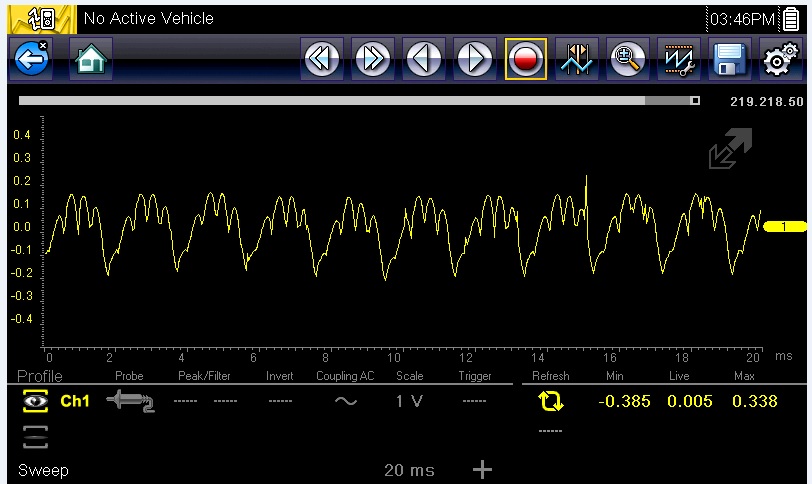

Man, that's a pretty good picture for using Paint! I've seen similar alternator ripple waveforms when I had the time scale set too long, resulting in scope aliasing. Do you recall what the time scale was during your testing?
Just as an example, this is a capture I took off a Honda with a failing alternator:
This one had a failed diode and low output. Note the 20ms screen time - that's around what you'll need to see detail in your alternator ripple waveform.

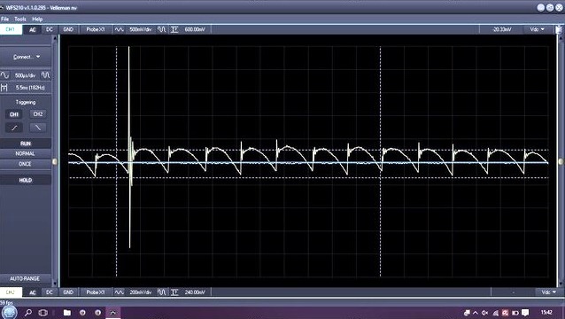

Alternator ripples patterns vary a lot.
This is a good (at least working with no problems) voltage waveform from a high mileage late 1990s Denso atlernator. The scope is set to AC volts.

I would agree with you about the scope settings however this pattern shows up in all time scales and the fact that it seems like a good pattern (minus the amplitude) is in their some of the time. I will definitely hook the scope up again and test some more this weekend. I cannot recall what time base i was using i just adjusted the time base until I could get a good picture of all the action.

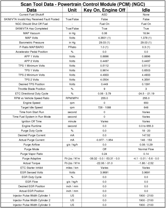

I have a alldatadiy account and under throttle body install the last step is:
A Scan Tool may be used to learn electrical parameters. Go to the Miscellaneous menu, and then select ETC Relearn. If the relearn is not preformed, a Diagnostic Trouble Code (DTC) will be set. If necessary, use a scan tool to erase any Diagnostic Trouble Codes (DTC's) from PCM.
The throttle body and gas pedal have been replaced (I know.... I should have tested. We will call that a "learning experience") and no relearn has been done. No codes have ever been thrown so what ever values may be stored in memory are not far off enough to cause a DTC to be triggered but might be off enough to cause low load issues.
Here's a table i found on alldata showing that minimum and maximum TPS values are stored I just dont know when if they update over time or are stored for life. The TPS is built into the throttle body so its possible that they may be out just enough. Might be barking up the wrong tree again though.
The throttle body is made by siemens/VDO which was probably taken from Mercedes and is used in VW's\Audi's. There is much more info available for the German cars and from what I can find a relearn must be done after throttle body replacement and even cleaning.
