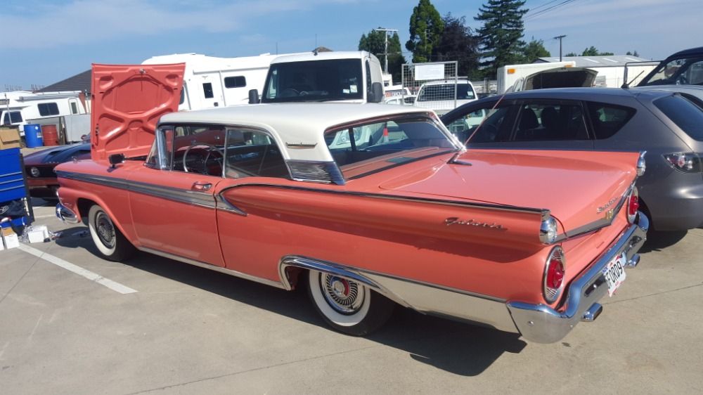

1959 Ford galaxie backing lights
- Paul6004
- Posts: 79
- Thank you received: 9
7 years 9 months ago #26066
by Paul6004
1959 Ford galaxie backing lights was created by Paul6004

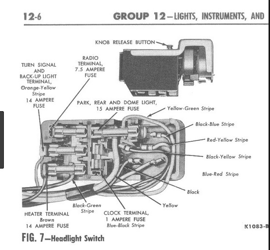

7 years 9 months ago #26075
Replied by Andy.MacFadyen on topic 1959 Ford galaxie backing lights
No 12v supply at the switch key on ?
No other ignition switched items not working ?
This was the only Ford wiring diagram of that era I could find that included back-up lights not easy to follow but it gives you the wiring colours.
www.oldcarmanualproject.com/tOCMP/wiring...rd/MWire5765-201.jpg

7 years 9 months ago #26080
by Paul6004
Replied by Paul6004 on topic 1959 Ford galaxie backing lights
Thanks very much for the effort Andy, that's very helpful. I only saw two fuses on the back of that switch but I might have to get my head deeper in there and use the mirror as well
