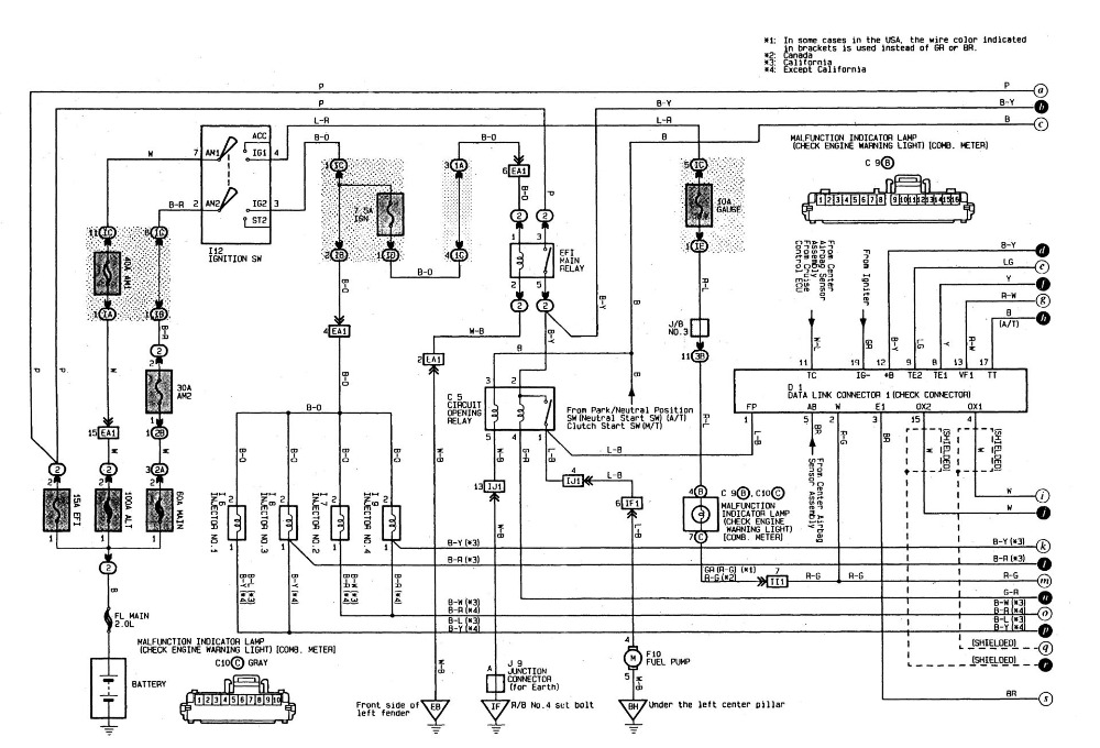

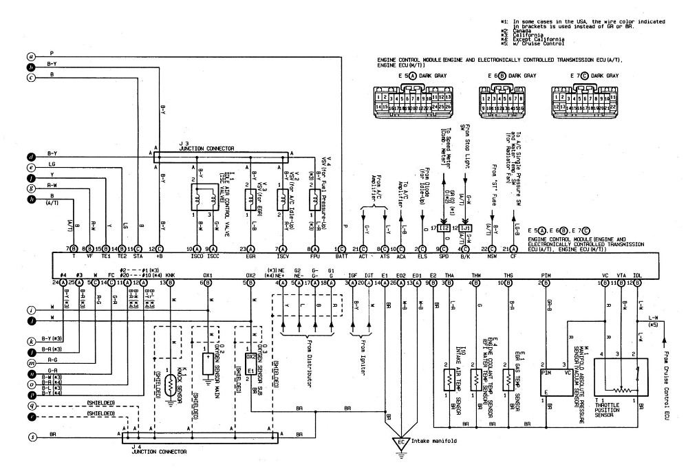

1 year 5 months ago #91824 by Noah
Replied by Noah on topic 5S-FE crank, no start, no spark…
Noah, those videos are the reason I am here, have tried to follow through them while with the car, but I do not have access to a scope!
Time to make the investment! A scope isn't a luxury or option for today's auto repair technician. There are more affordable scope options on the market today than ever before.
I can't find a complete PCM pin out, but these diagrams should have what you are looking for.

1 year 4 months ago #91860 by Noah
But still not seeing a check engine light
That's new information. If there's no engine light present, I like to check for 5v on a MAP, TPS etc. to see if the computer is "alive".
Were you able to use the diagram to verify all the powers and grounds are present to the engine computer?
